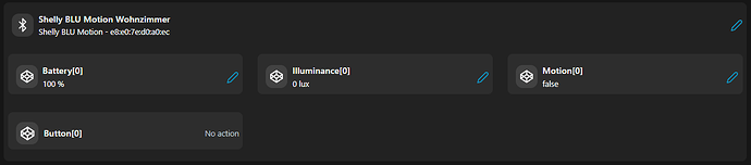

It looks like this in the Shelly web-ui, therefore I think this part is working.
Has anyone a Shelly BLU motion sensor working via gateway?

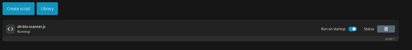

  1. Try to enable the gateway mode on the shelly2pm-Thing with the setting: enableBluGateway=“true”, once done (and refreshed) OH will push a script called “oh-blu-scanner.js” to the 2pm - you will be able to see it on the 2pm web-interface, section scripts:
