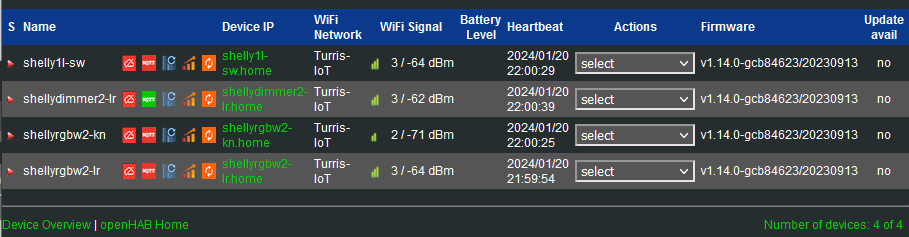

I have a setup with four Shellies which worked perfectly for months.
At some point last weeks (change of internet connection, thus change of the wireless router) I decided to re-structure my home network and put the Shellies to a separate network.
Thus I entered new WiFi configuration on my Shellies.
The only thing I changed in openHAB *.things
file was the hostname of the devices.
But since then I have problems with two of them, the other two run rock solid, and I don’t know what’s different.
shelly1l-sw
runs solid, just has some restarts (that’s working as designed on Shelly 1L devices)shellydimmer2-lr
shows communication errorsshellyrgbw2-kn
runs solidshellyrgbw2-lr
WiFi log shows permanent connection for shellyrgbw2-lr
, no reconnects:

2024-01-20 13:55:21.697 [INFO ] [ab.event.ThingStatusInfoChangedEvent] - Thing 'shelly:shellyrgbw2-white:shellyrgbw2-lr' changed from ONLINE to OFFLINE (COMMUNICATION_ERROR): Unable to connect to device - {0}
2024-01-20 13:55:25.783 [INFO ] [ab.event.ThingStatusInfoChangedEvent] - Thing 'shelly:shellydimmer2:shellydimmer2-lr' changed from ONLINE to OFFLINE (COMMUNICATION_ERROR): Unable to connect to device - {0}
2024-01-20 13:56:21.864 [INFO ] [ab.event.ThingStatusInfoChangedEvent] - Thing 'shelly:shellyrgbw2-white:shellyrgbw2-lr' changed from OFFLINE (COMMUNICATION_ERROR): Unable to connect to device - {0} to ONLINE
2024-01-20 13:57:21.987 [INFO ] [ab.event.ThingStatusInfoChangedEvent] - Thing 'shelly:shellyrgbw2-white:shellyrgbw2-lr' changed from ONLINE to OFFLINE (COMMUNICATION_ERROR): Unable to connect to device - {0}
2024-01-20 13:58:22.295 [INFO ] [ab.event.ThingStatusInfoChangedEvent] - Thing 'shelly:shellyrgbw2-white:shellyrgbw2-lr' changed from OFFLINE (COMMUNICATION_ERROR): Unable to connect to device - {0} to ONLINE
2024-01-20 13:59:22.490 [INFO ] [ab.event.ThingStatusInfoChangedEvent] - Thing 'shelly:shellyrgbw2-white:shellyrgbw2-lr' changed from ONLINE to OFFLINE (COMMUNICATION_ERROR): Unable to connect to device - {0}
2024-01-20 14:00:22.727 [INFO ] [ab.event.ThingStatusInfoChangedEvent] - Thing 'shelly:shellyrgbw2-white:shellyrgbw2-lr' changed from OFFLINE (COMMUNICATION_ERROR): Unable to connect to device - {0} to ONLINE
2024-01-20 14:00:25.960 [INFO ] [ab.event.ThingStatusInfoChangedEvent] - Thing 'shelly:shellydimmer2:shellydimmer2-lr' changed from OFFLINE (COMMUNICATION_ERROR): Unable to connect to device - {0} to ONLINE
2024-01-20 14:21:24.895 [INFO ] [openhab.event.ChannelTriggeredEvent ] - shelly:shelly1l:shelly1l-sw:device#alarm triggered RESTARTED
2024-01-20 14:21:24.897 [INFO ] [ab.event.ThingStatusInfoChangedEvent] - Thing 'shelly:shelly1l:shelly1l-sw' changed from ONLINE to UNKNOWN (CONFIGURATION_PENDING): The device has restarted and will be re-initialized.
2024-01-20 14:21:26.507 [INFO ] [ab.event.ThingStatusInfoChangedEvent] - Thing 'shelly:shellyrgbw2-white:shellyrgbw2-lr' changed from ONLINE to OFFLINE (COMMUNICATION_ERROR): Unable to connect to device - {0}
2024-01-20 14:21:28.191 [INFO ] [ab.event.ThingStatusInfoChangedEvent] - Thing 'shelly:shelly1l:shelly1l-sw' changed from UNKNOWN (CONFIGURATION_PENDING): The device has restarted and will be re-initialized. to ONLINE
2024-01-20 14:22:27.993 [INFO ] [ab.event.ThingStatusInfoChangedEvent] - Thing 'shelly:shellydimmer2:shellydimmer2-lr' changed from ONLINE to OFFLINE (COMMUNICATION_ERROR): Unable to connect to device - {0}
2024-01-20 14:23:26.658 [INFO ] [ab.event.ThingStatusInfoChangedEvent] - Thing 'shelly:shellyrgbw2-white:shellyrgbw2-lr' changed from OFFLINE (COMMUNICATION_ERROR): Unable to connect to device - {0} to ONLINE
2024-01-20 14:24:26.774 [INFO ] [ab.event.ThingStatusInfoChangedEvent] - Thing 'shelly:shellyrgbw2-white:shellyrgbw2-lr' changed from ONLINE to OFFLINE (COMMUNICATION_ERROR): Unable to connect to device - {0}
2024-01-20 14:25:28.338 [INFO ] [ab.event.ThingStatusInfoChangedEvent] - Thing 'shelly:shellydimmer2:shellydimmer2-lr' changed from OFFLINE (COMMUNICATION_ERROR): Unable to connect to device - {0} to ONLINE
2024-01-20 14:27:27.106 [INFO ] [ab.event.ThingStatusInfoChangedEvent] - Thing 'shelly:shellyrgbw2-white:shellyrgbw2-lr' changed from OFFLINE (COMMUNICATION_ERROR): Unable to connect to device - {0} to ONLINE
2024-01-20 14:30:27.670 [INFO ] [ab.event.ThingStatusInfoChangedEvent] - Thing 'shelly:shellyrgbw2-white:shellyrgbw2-lr' changed from ONLINE to OFFLINE (COMMUNICATION_ERROR): Unable to connect to device - {0}
2024-01-20 14:31:27.838 [INFO ] [ab.event.ThingStatusInfoChangedEvent] - Thing 'shelly:shellyrgbw2-white:shellyrgbw2-lr' changed from OFFLINE (COMMUNICATION_ERROR): Unable to connect to device - {0} to ONLINE
2024-01-20 14:35:28.443 [INFO ] [ab.event.ThingStatusInfoChangedEvent] - Thing 'shelly:shellyrgbw2-white:shellyrgbw2-lr' changed from ONLINE to OFFLINE (COMMUNICATION_ERROR): Unable to connect to device - {0}
2024-01-20 14:36:28.799 [INFO ] [ab.event.ThingStatusInfoChangedEvent] - Thing 'shelly:shellyrgbw2-white:shellyrgbw2-lr' changed from OFFLINE (COMMUNICATION_ERROR): Unable to connect to device - {0} to ONLINE
2024-01-20 14:40:29.589 [INFO ] [ab.event.ThingStatusInfoChangedEvent] - Thing 'shelly:shellyrgbw2-white:shellyrgbw2-lr' changed from ONLINE to OFFLINE (COMMUNICATION_ERROR): Unable to connect to device - {0}
2024-01-20 14:41:29.864 [INFO ] [ab.event.ThingStatusInfoChangedEvent] - Thing 'shelly:shellyrgbw2-white:shellyrgbw2-lr' changed from OFFLINE (COMMUNICATION_ERROR): Unable to connect to device - {0} to ONLINE
2024-01-20 14:45:30.333 [INFO ] [ab.event.ThingStatusInfoChangedEvent] - Thing 'shelly:shellyrgbw2-white:shellyrgbw2-lr' changed from ONLINE to OFFLINE (COMMUNICATION_ERROR): Unable to connect to device - {0}
2024-01-20 14:46:30.609 [INFO ] [ab.event.ThingStatusInfoChangedEvent] - Thing 'shelly:shellyrgbw2-white:shellyrgbw2-lr' changed from OFFLINE (COMMUNICATION_ERROR): Unable to connect to device - {0} to ONLINE
2024-01-20 14:46:30.785 [INFO ] [ab.event.ThingStatusInfoChangedEvent] - Thing 'shelly:shellydimmer2:shellydimmer2-lr' changed from ONLINE to OFFLINE (COMMUNICATION_ERROR): Unable to connect to device - {0}
2024-01-20 14:50:31.066 [INFO ] [ab.event.ThingStatusInfoChangedEvent] - Thing 'shelly:shellydimmer2:shellydimmer2-lr' changed from OFFLINE (COMMUNICATION_ERROR): Unable to connect to device - {0} to ONLINE
2024-01-20 15:00:32.417 [INFO ] [ab.event.ThingStatusInfoChangedEvent] - Thing 'shelly:shellydimmer2:shellydimmer2-lr' changed from ONLINE to OFFLINE (COMMUNICATION_ERROR): Unable to connect to device - {0}
2024-01-20 15:02:32.791 [INFO ] [ab.event.ThingStatusInfoChangedEvent] - Thing 'shelly:shellydimmer2:shellydimmer2-lr' changed from OFFLINE (COMMUNICATION_ERROR): Unable to connect to device - {0} to ONLINE
2024-01-20 15:05:34.893 [INFO ] [ab.event.ThingStatusInfoChangedEvent] - Thing 'shelly:shellyrgbw2-white:shellyrgbw2-lr' changed from ONLINE to OFFLINE (COMMUNICATION_ERROR): Unable to connect to device - {0}
2024-01-20 15:07:35.047 [INFO ] [ab.event.ThingStatusInfoChangedEvent] - Thing 'shelly:shellyrgbw2-white:shellyrgbw2-lr' changed from OFFLINE (COMMUNICATION_ERROR): Unable to connect to device - {0} to ONLINE
2024-01-20 15:10:34.475 [INFO ] [ab.event.ThingStatusInfoChangedEvent] - Thing 'shelly:shellydimmer2:shellydimmer2-lr' changed from ONLINE to OFFLINE (COMMUNICATION_ERROR): Unable to connect to device - {0}
2024-01-20 15:10:35.520 [INFO ] [ab.event.ThingStatusInfoChangedEvent] - Thing 'shelly:shellyrgbw2-white:shellyrgbw2-lr' changed from ONLINE to OFFLINE (COMMUNICATION_ERROR): Unable to connect to device - {0}
2024-01-20 15:12:34.706 [INFO ] [ab.event.ThingStatusInfoChangedEvent] - Thing 'shelly:shellydimmer2:shellydimmer2-lr' changed from OFFLINE (COMMUNICATION_ERROR): Unable to connect to device - {0} to ONLINE
2024-01-20 15:12:35.694 [INFO ] [ab.event.ThingStatusInfoChangedEvent] - Thing 'shelly:shellyrgbw2-white:shellyrgbw2-lr' changed from OFFLINE (COMMUNICATION_ERROR): Unable to connect to device - {0} to ONLINE
2024-01-20 15:13:35.834 [INFO ] [ab.event.ThingStatusInfoChangedEvent] - Thing 'shelly:shellyrgbw2-white:shellyrgbw2-lr' changed from ONLINE to OFFLINE (COMMUNICATION_ERROR): Unable to connect to device - {0}
2024-01-20 15:14:35.007 [INFO ] [ab.event.ThingStatusInfoChangedEvent] - Thing 'shelly:shellydimmer2:shellydimmer2-lr' changed from ONLINE to OFFLINE (COMMUNICATION_ERROR): Unable to connect to device - {0}
2024-01-20 15:15:36.120 [INFO ] [ab.event.ThingStatusInfoChangedEvent] - Thing 'shelly:shellyrgbw2-white:shellyrgbw2-lr' changed from OFFLINE (COMMUNICATION_ERROR): Unable to connect to device - {0} to ONLINE
2024-01-20 15:16:35.165 [INFO ] [ab.event.ThingStatusInfoChangedEvent] - Thing 'shelly:shellydimmer2:shellydimmer2-lr' changed from OFFLINE (COMMUNICATION_ERROR): Unable to connect to device - {0} to ONLINE
2024-01-20 15:19:36.912 [INFO ] [ab.event.ThingStatusInfoChangedEvent] - Thing 'shelly:shellyrgbw2-white:shellyrgbw2-lr' changed from ONLINE to OFFLINE (COMMUNICATION_ERROR): Unable to connect to device - {0}
2024-01-20 15:20:35.764 [INFO ] [ab.event.ThingStatusInfoChangedEvent] - Thing 'shelly:shellydimmer2:shellydimmer2-lr' changed from ONLINE to OFFLINE (COMMUNICATION_ERROR): Unable to connect to device - {0}
2024-01-20 15:20:37.094 [INFO ] [ab.event.ThingStatusInfoChangedEvent] - Thing 'shelly:shellyrgbw2-white:shellyrgbw2-lr' changed from OFFLINE (COMMUNICATION_ERROR): Unable to connect to device - {0} to ONLINE
2024-01-20 15:21:36.090 [INFO ] [ab.event.ThingStatusInfoChangedEvent] - Thing 'shelly:shellydimmer2:shellydimmer2-lr' changed from OFFLINE (COMMUNICATION_ERROR): Unable to connect to device - {0} to ONLINE
2024-01-20 15:24:36.590 [INFO ] [ab.event.ThingStatusInfoChangedEvent] - Thing 'shelly:shellydimmer2:shellydimmer2-lr' changed from ONLINE to OFFLINE (COMMUNICATION_ERROR): Unable to connect to device - {0}
2024-01-20 15:24:37.765 [INFO ] [ab.event.ThingStatusInfoChangedEvent] - Thing 'shelly:shellyrgbw2-white:shellyrgbw2-lr' changed from ONLINE to OFFLINE (COMMUNICATION_ERROR): Unable to connect to device - {0}
2024-01-20 15:25:38.052 [INFO ] [ab.event.ThingStatusInfoChangedEvent] - Thing 'shelly:shellyrgbw2-white:shellyrgbw2-lr' changed from OFFLINE (COMMUNICATION_ERROR): Unable to connect to device - {0} to ONLINE
2024-01-20 15:26:36.946 [INFO ] [ab.event.ThingStatusInfoChangedEvent] - Thing 'shelly:shellydimmer2:shellydimmer2-lr' changed from OFFLINE (COMMUNICATION_ERROR): Unable to connect to device - {0} to ONLINE
2024-01-20 15:27:37.051 [INFO ] [ab.event.ThingStatusInfoChangedEvent] - Thing 'shelly:shellydimmer2:shellydimmer2-lr' changed from ONLINE to OFFLINE (COMMUNICATION_ERROR): Unable to connect to device - {0}
2024-01-20 15:28:37.367 [INFO ] [ab.event.ThingStatusInfoChangedEvent] - Thing 'shelly:shellydimmer2:shellydimmer2-lr' changed from OFFLINE (COMMUNICATION_ERROR): Unable to connect to device - {0} to ONLINE
2024-01-20 15:29:38.588 [INFO ] [ab.event.ThingStatusInfoChangedEvent] - Thing 'shelly:shellyrgbw2-white:shellyrgbw2-lr' changed from ONLINE to OFFLINE (COMMUNICATION_ERROR): Unable to connect to device - {0}
2024-01-20 15:31:37.783 [INFO ] [ab.event.ThingStatusInfoChangedEvent] - Thing 'shelly:shellydimmer2:shellydimmer2-lr' changed from ONLINE to OFFLINE (COMMUNICATION_ERROR): Unable to connect to device - {0}
2024-01-20 15:31:38.719 [INFO ] [ab.event.ThingStatusInfoChangedEvent] - Thing 'shelly:shellyrgbw2-white:shellyrgbw2-lr' changed from OFFLINE (COMMUNICATION_ERROR): Unable to connect to device - {0} to ONLINE
2024-01-20 15:32:38.116 [INFO ] [ab.event.ThingStatusInfoChangedEvent] - Thing 'shelly:shellydimmer2:shellydimmer2-lr' changed from OFFLINE (COMMUNICATION_ERROR): Unable to connect to device - {0} to ONLINE
2024-01-20 15:33:38.222 [INFO ] [ab.event.ThingStatusInfoChangedEvent] - Thing 'shelly:shellydimmer2:shellydimmer2-lr' changed from ONLINE to OFFLINE (COMMUNICATION_ERROR): Unable to connect to device - {0}
2024-01-20 15:35:38.380 [INFO ] [ab.event.ThingStatusInfoChangedEvent] - Thing 'shelly:shellydimmer2:shellydimmer2-lr' changed from OFFLINE (COMMUNICATION_ERROR): Unable to connect to device - {0} to ONLINE
2024-01-20 15:36:38.484 [INFO ] [ab.event.ThingStatusInfoChangedEvent] - Thing 'shelly:shellydimmer2:shellydimmer2-lr' changed from ONLINE to OFFLINE (COMMUNICATION_ERROR): Unable to connect to device - {0}
2024-01-20 15:37:38.808 [INFO ] [ab.event.ThingStatusInfoChangedEvent] - Thing 'shelly:shellydimmer2:shellydimmer2-lr' changed from OFFLINE (COMMUNICATION_ERROR): Unable to connect to device - {0} to ONLINE
2024-01-20 15:40:40.125 [INFO ] [ab.event.ThingStatusInfoChangedEvent] - Thing 'shelly:shellyrgbw2-white:shellyrgbw2-lr' changed from ONLINE to OFFLINE (COMMUNICATION_ERROR): Unable to connect to device - {0}
2024-01-20 15:42:40.400 [INFO ] [ab.event.ThingStatusInfoChangedEvent] - Thing 'shelly:shellyrgbw2-white:shellyrgbw2-lr' changed from OFFLINE (COMMUNICATION_ERROR): Unable to connect to device - {0} to ONLINE
2024-01-20 15:44:39.614 [INFO ] [ab.event.ThingStatusInfoChangedEvent] - Thing 'shelly:shellydimmer2:shellydimmer2-lr' changed from ONLINE to OFFLINE (COMMUNICATION_ERROR): Unable to connect to device - {0}
2024-01-20 15:44:40.667 [INFO ] [ab.event.ThingStatusInfoChangedEvent] - Thing 'shelly:shellyrgbw2-white:shellyrgbw2-lr' changed from ONLINE to OFFLINE (COMMUNICATION_ERROR): Unable to connect to device - {0}
2024-01-20 15:45:40.830 [INFO ] [ab.event.ThingStatusInfoChangedEvent] - Thing 'shelly:shellyrgbw2-white:shellyrgbw2-lr' changed from OFFLINE (COMMUNICATION_ERROR): Unable to connect to device - {0} to ONLINE
2024-01-20 15:46:40.888 [INFO ] [ab.event.ThingStatusInfoChangedEvent] - Thing 'shelly:shellydimmer2:shellydimmer2-lr' changed from OFFLINE (COMMUNICATION_ERROR): Unable to connect to device - {0} to ONLINE
2024-01-20 15:46:40.951 [INFO ] [ab.event.ThingStatusInfoChangedEvent] - Thing 'shelly:shellyrgbw2-white:shellyrgbw2-lr' changed from ONLINE to OFFLINE (COMMUNICATION_ERROR): Unable to connect to device - {0}
2024-01-20 15:47:40.993 [INFO ] [ab.event.ThingStatusInfoChangedEvent] - Thing 'shelly:shellydimmer2:shellydimmer2-lr' changed from ONLINE to OFFLINE (COMMUNICATION_ERROR): Unable to connect to device - {0}
2024-01-20 15:47:41.151 [INFO ] [ab.event.ThingStatusInfoChangedEvent] - Thing 'shelly:shellyrgbw2-white:shellyrgbw2-lr' changed from OFFLINE (COMMUNICATION_ERROR): Unable to connect to device - {0} to ONLINE
2024-01-20 15:49:41.199 [INFO ] [ab.event.ThingStatusInfoChangedEvent] - Thing 'shelly:shellydimmer2:shellydimmer2-lr' changed from OFFLINE (COMMUNICATION_ERROR): Unable to connect to device - {0} to ONLINE
2024-01-20 15:50:41.523 [INFO ] [ab.event.ThingStatusInfoChangedEvent] - Thing 'shelly:shellyrgbw2-white:shellyrgbw2-lr' changed from ONLINE to OFFLINE (COMMUNICATION_ERROR): Unable to connect to device - {0}
2024-01-20 15:51:41.400 [INFO ] [ab.event.ThingStatusInfoChangedEvent] - Thing 'shelly:shellydimmer2:shellydimmer2-lr' changed from ONLINE to OFFLINE (COMMUNICATION_ERROR): Unable to connect to device - {0}
2024-01-20 15:51:41.679 [INFO ] [ab.event.ThingStatusInfoChangedEvent] - Thing 'shelly:shellyrgbw2-white:shellyrgbw2-lr' changed from OFFLINE (COMMUNICATION_ERROR): Unable to connect to device - {0} to ONLINE
2024-01-20 15:52:41.727 [INFO ] [ab.event.ThingStatusInfoChangedEvent] - Thing 'shelly:shellydimmer2:shellydimmer2-lr' changed from OFFLINE (COMMUNICATION_ERROR): Unable to connect to device - {0} to ONLINE
How can I continue to debug this and track down the problem?
