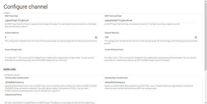

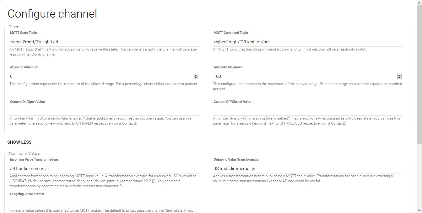

I do this with some zigbee2mqtt bulbs:
and
The tranformation:
(function(brightness) {
    if (brightness > 0) {
        var shellyobj = { "turn":"on", "brightness":brightness};
    } else {
        var shellyobj = { "turn":"off", "brightness":0 };
    var data = JSON.stringify(shellyobj);
    return data;
})(input)
