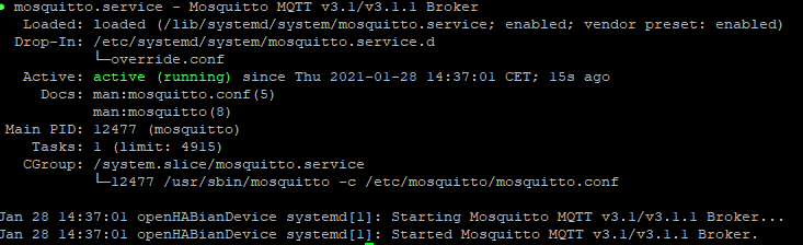

Did you check that Mosquitto is indeed up and running?
Initially, my configuration did not work because Mosquitto was not running.
