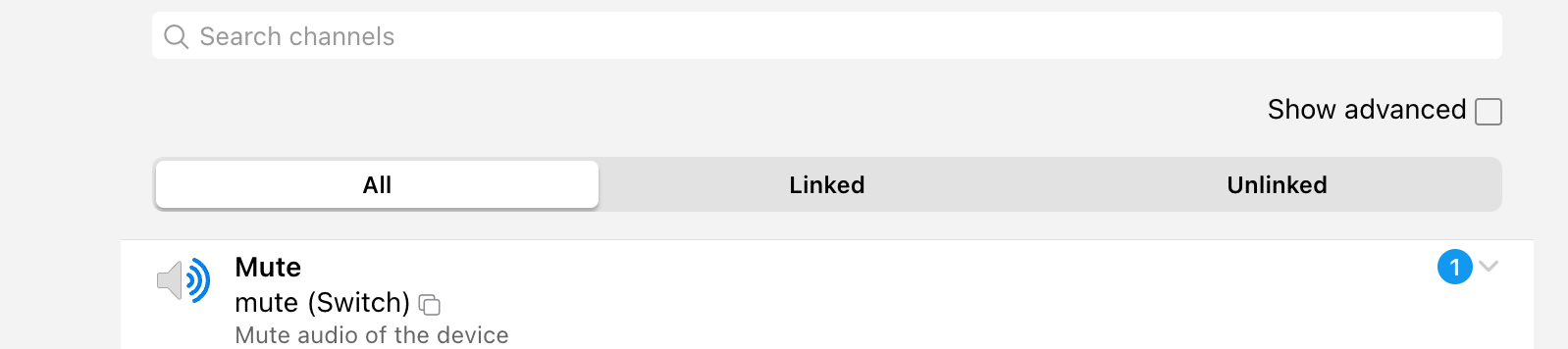

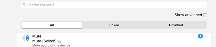

Did you click “Show Advanced”?
Yep. It only shows last measure timestamp for each meter. Also, I’m reading on the thing that the total energy consumption shall be reset on reboot, but it seems not to be doing that when rebooting from the app. Meter2 and meter3 keeps their last values.
