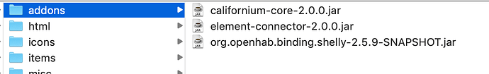

I put all three jar files in the addons folder but I don’t see any of them under “bundle:list”. Sorry, but I’ve never installed or used a DEV or SNAPSHOT binding :roll_eyes:
You have not copied the 2.5.9 DEV build into the addons folder, but an older 2.5.8 version …
I copied the file “org.openhab.binding.shelly-2.5.9-SNAPSHOT.jar” into the addons folder.
The instructions are still based on 2.5.8
OK then, your screenshot shows 2.5.8
I think I wasn’t clear enough. Sorry!
What I posted (regarding 2.5.8) was part of the instructions from here: myfiles/shelly/READMEbeta.md at master · markus7017/myfiles · GitHub
It says “If everything was install correct a “bundle:list” output show be similar to this”. But I don’t see any of these bundles in my installation after following these steps.

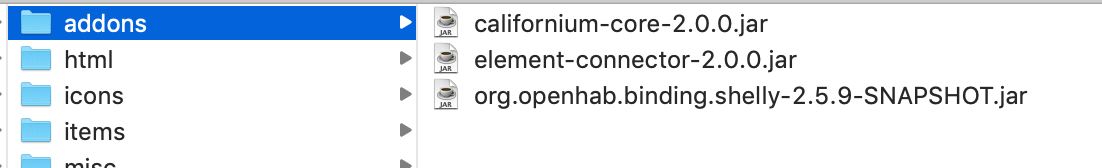

My addons folder looks like this:
The “normal” binding found in PaperUI is supposed to be uninstalled, right?
Correct
