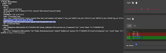

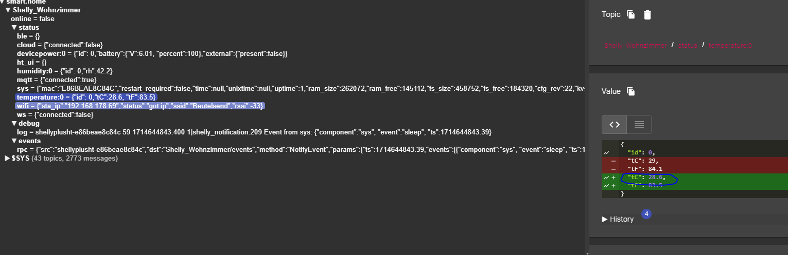

Unfortunately, I can’t manage to integrate a Shelly H&T Plus via MQTT. I can see the data in the MQTT explorer, but unfortunately I can’t manage to extract the data:
I want to extract the humidity and temperature.
This is how I proceeded:
MQTT broker set up with my access data, this also shows the status ‘ONLINE’.
Then I created a new device and a channel as number:
For temperature I use follow MQTT State Topic: Shelly_Wohnzimmer/status/temperature:0
See pictures below:

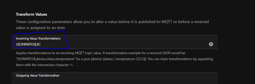

and for Incoming Value Transformation, I used JSONPATH:$.tC
See pictures below as well:
Same issue with humidity value.
It doesn’t work. What am I doing wrong? Thank you very much!
