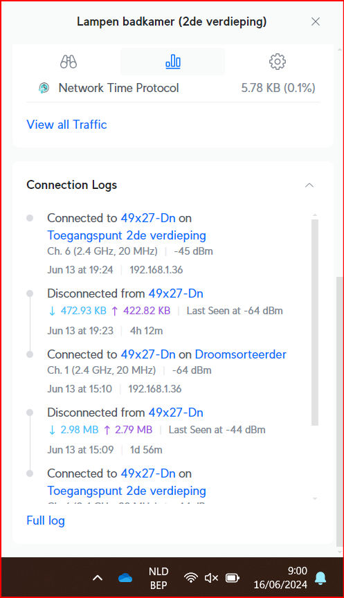

My router, however, claims the device was never disconnected (today):
Does anyone recognize this behaviour, or know any additional logging I could provide?

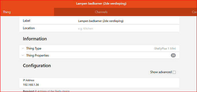

Therefore I would first check if the Thing is configured with the same IP-Address than the router reports.
If this matches, I would sssh into the openHAB server and ping that device from the console.
If it responds, I would restart the Binding…
