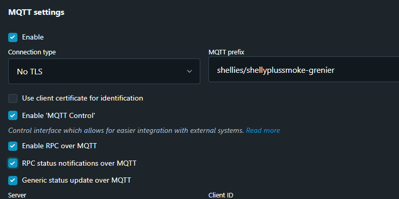

Update: I understood that the mosquitto logs will not show me more than that… So I went the mosquitto_sub way and I see the smoke device messages but I’m a bit surprised by what I see as it has really as simple as what I’m used to (e.g. zigbee2mqtt messages)…
So, really, I have 2 questions:
  1. What settings I should use on the shelly device itself. I started by checking everything but I’m not sure anymore…
  2. An example of how to configure the channels on the mqtt thing associated to the smoke plus device would be great.
Thanks,
And for what it is worth, I have also understood that if I don’t re-enter the password in the password box for the MQTT server each and everytime I change a parameter the password setting is lost and nothing works, of course…
