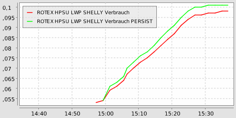

2020-08-27 15:34:00.621 [vent.ItemStateChangedEvent] - RotexHPSULwpTotalKWH changed from 0.097 to 0.098
2020-08-27 15:34:00.792 [INFO ] [.script.ShellyEM rotex LWP PowerLoss] - delta: 0.0
--> STRANGE 0.000 delta shall be 0.001
2020-08-27 15:34:00.794 [INFO ] [.script.ShellyEM rotex LWP PowerLoss] - normal RotexHPSULwp-totalKWH  0.098 persist: 0.100999996
noting that the first time and many time in between it is working - i.e. proxy persistence item value and orignal value are same (if started from zero)
but why not working ? effect directly visible after 30mins

There are a few things that I can think of:
  • When there is a power loss, you essentially throw away the delta since the power loss. I think you want to add the absolute value of delta to RotexHPSULwpTotalKWH when the delta is negative.
  • You are working with small numbers. Computers are generally pretty bad and dealing with small floating point numbers. There are simple some numbers that are impossible to represent given the way programming languages typically represent floating point numbers. I wouldn’t be surprised if 0.021 is one of them, which is why you see 0.020999998 This will introduce errors which build up over time. I think BigDecimal is able to avoid some of this so instead of forcing stuff to be a primitive float, keep them as BigDecimal. Every place you have .floatValue cast the value to Number instead. This will keep it as BigDecimal and potentially avoid this growing loss of precision. In scientific computing, the values will actually be converted to integers instead of relying on unreliable floating point values. Some languages also support fixed precision numbers which are reliable and could be used. I don’t think any of these options are available for you in this case though.
  • You are using rrd4j which decimates the data as it ages. For example, it will take ten values and replace them with one value that is the average of the ten. I don’t think this is the case for this example as I think it doesn’t start doing that until the data gets over a day old (@opus can confirm). This too will introduce errors as the data ages.
I don’t know if any of these are relevant to what you are seeing or not but they are worth exploring.
