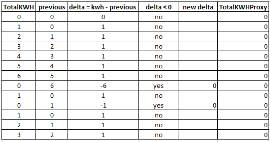

Hi rlkoshak, I think this can not work. Could you please review your code?
In this grafik I set a reset of two times but I guess your calculation will not work. What do you think?
Frankly, I don’t have a shelly power meter. There is no way I can test this. Also, errors in code often have as much or more to do with context. So post your code and maybe I can review that.
There’s only three lines of code here so there is not that much that can go wrong. Looking at that table I would guess that you are missing the third line of code that adds the delta to the current total: TotalKWHProxy.postUpdate(TotalKWHProxy.state + delta). Or you are not looking at the logs and there is an error with that line of code which the logs will be complaining about.
Ultimately, cargo-cult programming is not going to take you very far. You really need to have a basic understanding of what the code you are copying and pasting does, overall how it works, and how to look for errors. You also need to learn how to debug problems when you encounter them.
