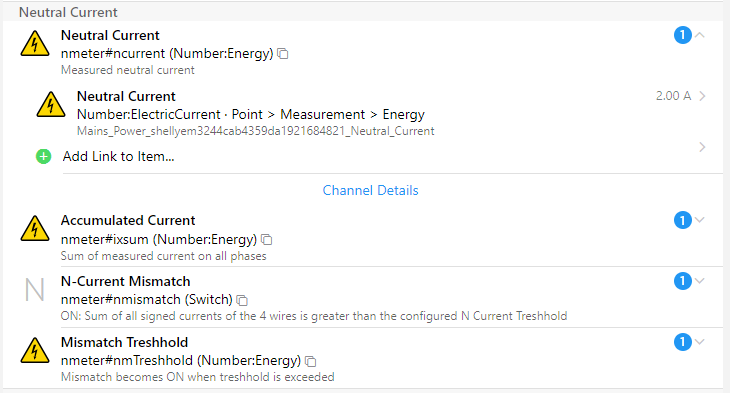

Hi Markus
Just restarted with newest snapshot 4.2.0 (Build #3900) and your provided ncurrent JAR.
Your Shelly binding turns up under other bindings. Very well.
And BINGO! The thing shows the new nCurrent channel:
UID: shelly:shellyem3:244cab4359da
label: Mains Power (shellyem3-244cab4359da@192.168.48.21)
thingTypeUID: shelly:shellyem3

- id: nmeter#ncurrent
channelTypeUID: shelly:ncurrent
label: Neutral Current
description: Measured neutral current
configuration: {}
- id: nmeter#ixsum
channelTypeUID: shelly:ixsum
label: Accumulated Current
description: Sum of measured current on all phases
configuration: {}
- id: nmeter#nmismatch
channelTypeUID: shelly:nmismatch
label: N-Current Mismatch
description: "ON: Sum of all signed currents of the 4 wires is greater than the
configured N Current Treshhold"
configuration: {}
- id: nmeter#nmTreshhold
channelTypeUID: shelly:nmTreshhold
label: Mismatch Treshhold

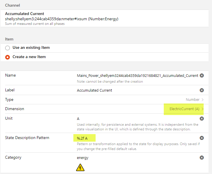

Adding new links to the nCurrent channels all result in NULL values on the OH UI.
There seems to be a problem in the unit definitions of the new channels, I don’t know if I can change the conversion rule.

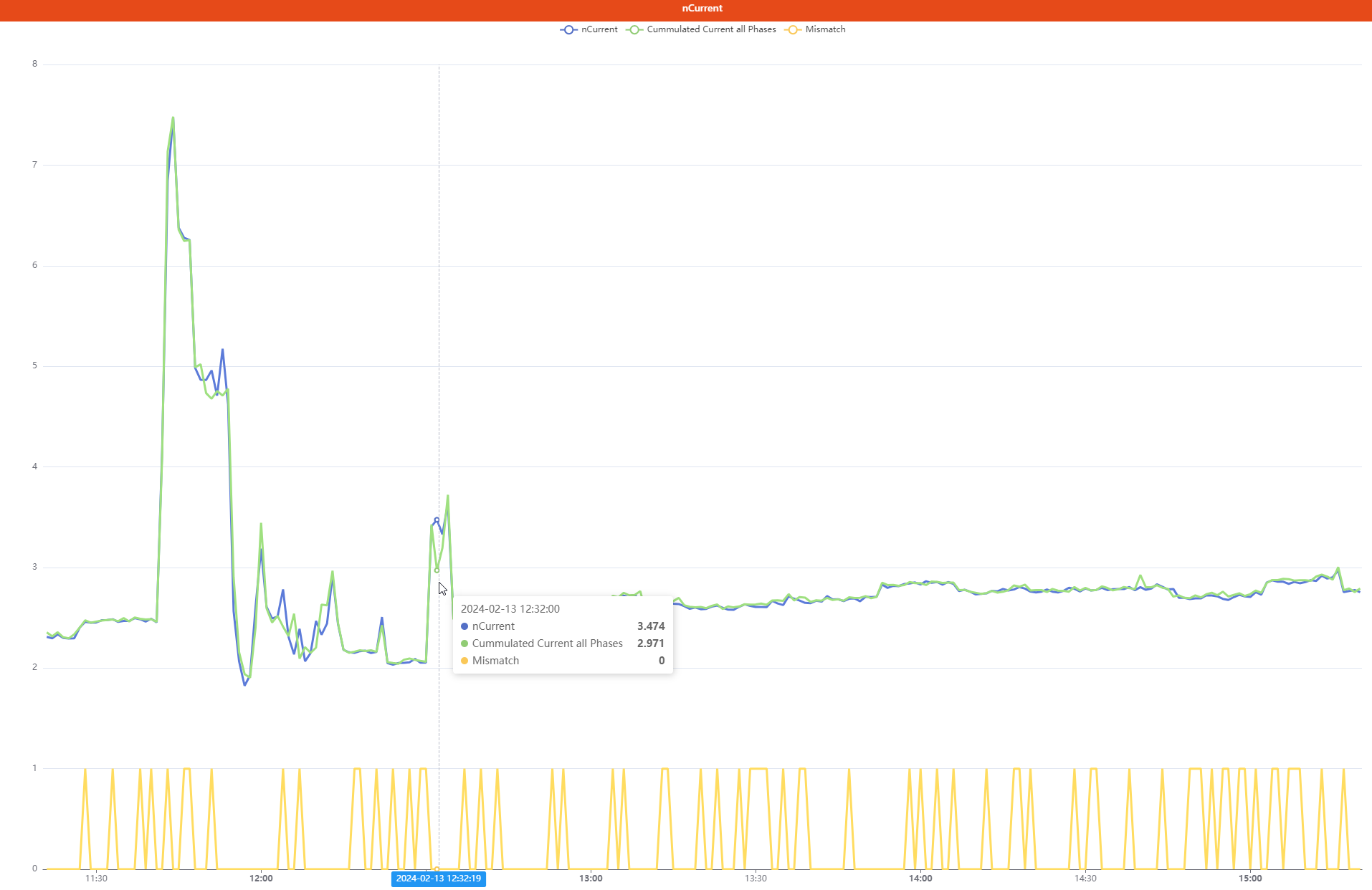

try updated build, but re-discover the thing (delete + discover)
Finally I needed to kick out the thing and setup the channel links again.
On all channels related to current, I needed to adapt the default settings for dimension from Energy (kWh) to Electric Current (A) and State Description Pattern from %0f to %.2f
Please take this as a suggestion for the default config.
With this setup I’m getting meaningful measurements and there are no further warnings visible in the log with respect to shelly. Thanks for your effort!!.

The thing should already create a channel of type Number:ElectricalCurrent, please check on a new thing config.
U change the default pattern to “%.3f %unit%”
Please check the new build.
Updated to OH 4.2 Build 3903
Nops, the thing’s channel comes always as number / Energy (kWh).
I have no clue, how to change the default pattern. Could u pls give me a hint?
