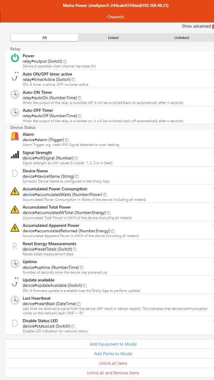

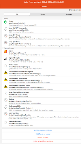

“[shelly] Stack Overflow reading N current from 3EM and no channel data
Running OH 4.1.0 official docker container on Synology. JVR is 17.0.9.
Using the ShellyBinding as it came with the distribution.

I also checked now the descriptors of that Shelly 3EM device, which looks fine to me. However
UID: shelly:shellyem3:244cab4359da
label: Mains Power
thingTypeUID: shelly:shellyem3
configuration:
  eventsCoIoT: true
  deviceIp: 192.168.48.21
  eventsSwitch: false
  updateInterval: 30
  eventsButton: false
  eventsPush: false
channels:
  - id: device#alarm
    channelTypeUID: shelly:alarmTrigger
    label: Alarm
    description: Alarm Trigger, e.g. weak WiFi Signal detected or over heating
    configuration: {}
  - id: device#wifiSignal
    channelTypeUID: system:signal-strength
    label: Signal Strength
    description: Signal strength as with values 0 (worst), 1, 2, 3 or 4 (best)
    configuration: {}
  - id: device#uptime
    channelTypeUID: shelly:uptime
    label: Uptime
    description: Number of seconds since the device was powered up
    configuration: {}
  - id: device#accumulatedWatts
    channelTypeUID: shelly:meterAccuWatts
    label: null
    description: null
    configuration: {}
  - id: device#accumulatedWTotal
    channelTypeUID: shelly:meterAccuTotal
    label: null
    description: null
    configuration: {}
  - id: device#accumulatedReturned
    channelTypeUID: shelly:meterAccuReturned
    label: null
    description: null
    configuration: {}
  - id: device#updateAvailable
    channelTypeUID: shelly:updateAvailable
    label: null
    description: null
    configuration: {}
  - id: device#heartBeat
    channelTypeUID: shelly:heartBeat
    label: null
    description: null
    configuration: {}
  - id: relay#output
    channelTypeUID: system:power
    label: null
    description: null
    configuration: {}
  - id: relay#autoOn
    channelTypeUID: shelly:timerAutoOn
    label: null
    description: null
    configuration: {}
  - id: relay#autoOff
    channelTypeUID: shelly:timerAutoOff
    label: null
    description: null
    configuration: {}
  - id: relay#timerActive
    channelTypeUID: shelly:timerActive
    label: null
    description: null
    configuration: {}
  - id: device#deviceName
    channelTypeUID: shelly:deviceName
    label: null
    description: null
    configuration: {}
  - id: device#statusLed
    channelTypeUID: shelly:ledStatusDisable
    label: null
    description: null
    configuration: {}
  - id: meter1#currentWatts
    channelTypeUID: shelly:meterWatts
    label: null
    description: null
    configuration: {}
  - id: meter1#totalKWH
    channelTypeUID: shelly:meterTotal
    label: null
    description: null
    configuration: {}
  - id: meter1#returnedKWH
    channelTypeUID: shelly:meterReturned
    label: null
    description: null
    configuration: {}
  - id: meter1#voltage
    channelTypeUID: shelly:meterVoltage
    label: null
    description: null
    configuration: {}
    channelTypeUID: shelly:meterCurrent
    label: null
    description: null
    configuration: {}
  - id: meter1#powerFactor
    channelTypeUID: shelly:meterPowerFactor
    label: null
    description: null
    configuration: {}
  - id: meter1#lastUpdate
    channelTypeUID: shelly:lastUpdate
    label: null
    description: null
    configuration: {}
  - id: meter2#currentWatts
    label: null
    description: null
    configuration: {}
  - id: meter2#totalKWH
    label: null
    description: null
    configuration: {}
  - id: meter2#returnedKWH
    label: null
    description: null
    configuration: {}
  - id: meter2#voltage
    label: null
    description: null
    configuration: {}
    label: null
    description: null
    configuration: {}
  - id: meter2#powerFactor
    label: null
    description: null
    configuration: {}
  - id: meter2#lastUpdate
    label: null
    description: null
    configuration: {}
  - id: meter3#currentWatts
    label: null
    description: null
    configuration: {}
  - id: meter3#totalKWH
    label: null
    description: null
    configuration: {}
  - id: meter3#returnedKWH
    label: null
    description: null
    configuration: {}
  - id: meter3#voltage
    label: null
    description: null
    configuration: {}
    label: null
    description: null
    configuration: {}
  - id: meter3#powerFactor
    label: null
    description: null
    configuration: {}
  - id: meter3#lastUpdate
    label: null
    description: null
    configuration: {}
  - id: device#resetTotals
    channelTypeUID: shelly:meterResetTotals
    label: Reset Energy Measurements
    description: Resets totals measurement data
    configuration: {}
Hope this context helps you finding the source of the problem.

Here’s the screenshot of the Shelly3EM. Does it show what you were looking for?

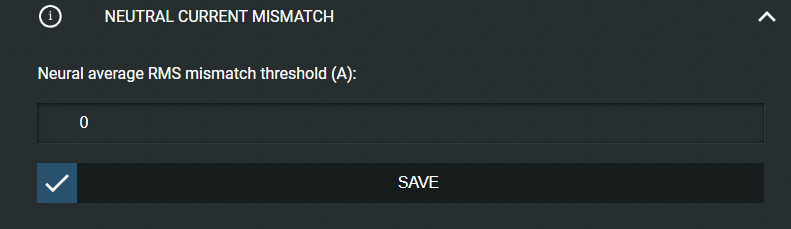

On the settings page a mismatch threshold can be configured. I assume that the property “mismatch” becomes true, if abs(ixsum) > threshold

Installed the Shelly binding now - however I could see two instances in the list but there was no obvious difference. Selected the first one.
openhab> bundle:list | grep Shelly
263 x Active x  80 x 4.2.0.202401091944     x openHAB Add-ons :: Bundles :: Shelly Binding Gen 1,2,3, BLU
Added Shelly 3EM as thing → works
Looking at the available channels, the list looks very short. I’m missing the three power meter channels and your new nmeter etc.
The logfile contains quite some errors. Have a look.

Hi Markus
Gave it another try, did the stuff again … unfortunately with the same results. Looks really that there is something wrong with the loaded addon.
Digging further down in the log and restarting several times, I got a startup sequence which doesn’t complain about a missing feature:
2024-01-16 22:13:40.970 [WARN ] [internal.service.FeaturesServiceImpl] - Can't load features repository mvn:org.openhab.core.features.karaf/org.openhab.core.features.karaf.openhab-core/4.2.0-SNAPSHOT/xml/features
java.lang.RuntimeException: Error resolving artifact org.openhab.core.features.karaf:org.openhab.core.features.karaf.openhab-core:xml:features:4.2.0-SNAPSHOT: [Could not find artifact org.openhab.core.features.karaf:org.openhab.core.features.karaf.openhab-core:xml:features:4.2.0-SNAPSHOT] : mvn:org.openhab.core.features.karaf/org.openhab.core.features.karaf.openhab-core/4.2.0-SNAPSHOT/xml/features

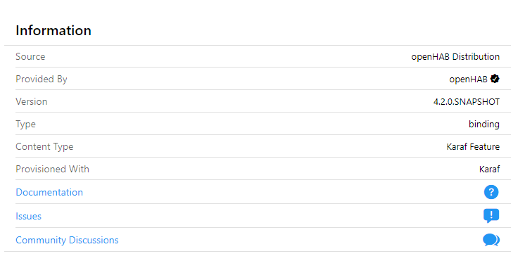

Or do I have to work with a OH 4.2-SNAPSHOT?
Here’s the startup sequence, shortened in between but at the end you’ll see a problem with the new N current channel:
Channel definition for meter#ncurrent not found!

is that with the latest binding?
