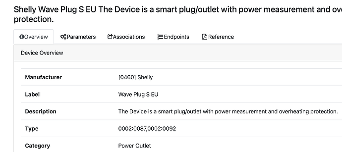

I was able to register, however I’m not able to edit an entry. Do you need to change my rights?
It seems to me that the device code is already in the database
in openhab the thing is added but the status of the device is unknown and therefore no channel available.
Martin
sihui
(SiHui)
June 27, 2026, 6:46pm
4
Not me, but the maintainer of the database. For that, please open a ticket and read the database guide .
Correct. Last approval of that entry was on 2026-04-13 18:32:23 , so you need an openHAB version newer than that date.
