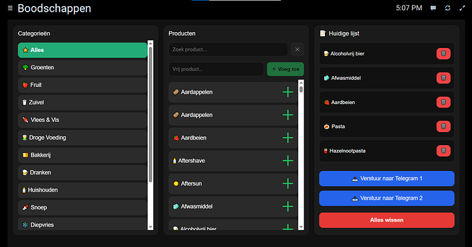

I built a HABPanel Template shopping list. The list is stored locally in one String item and can optionally be sent via Telegram. You only need the template and three String items: BringList, Telegram_1, and Telegram_2.
The UI text is in Dutch, but it’s easy to translate with AI.

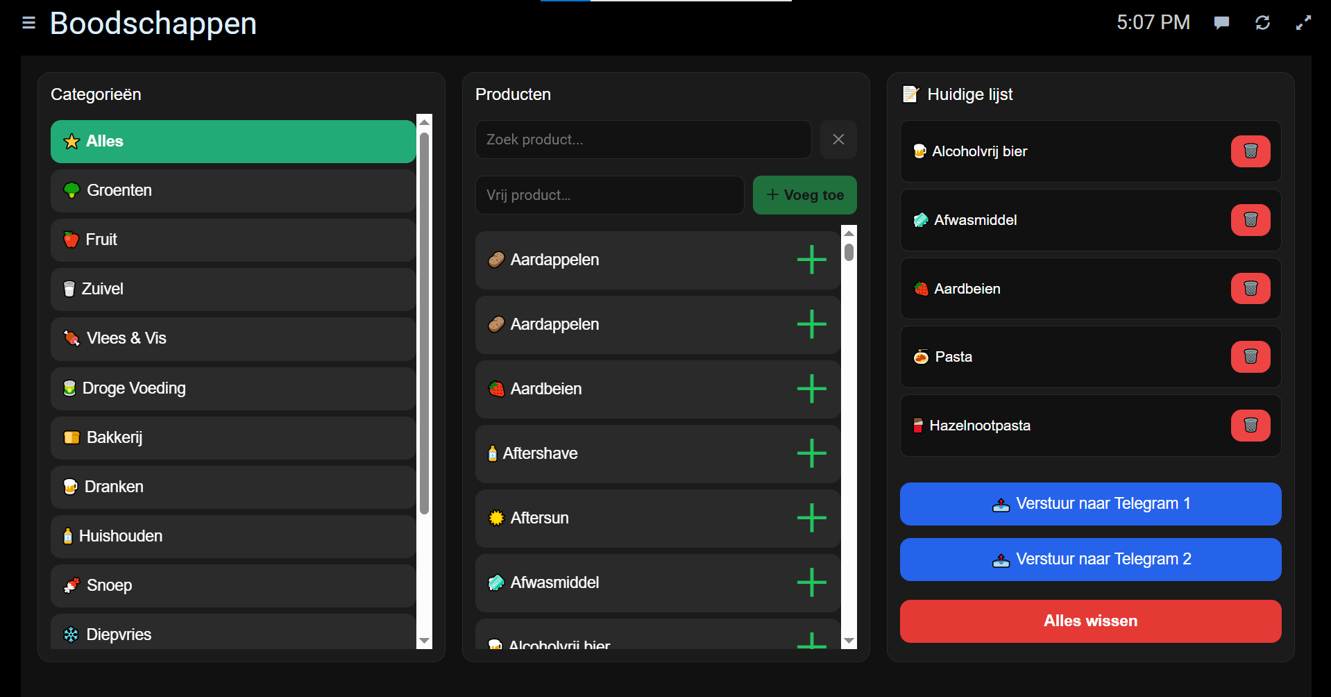

You can see scrollbars in this desktop screenshot, but on a wall-mounted tablet (fullscreen/kiosk) they’re not visible
What it does
  • HABPanel Template with categories, search, quick add, delete, clear.
  • Persists the list in a String item (no external storage).
  • Optional: send the current list to two Telegram chats.
