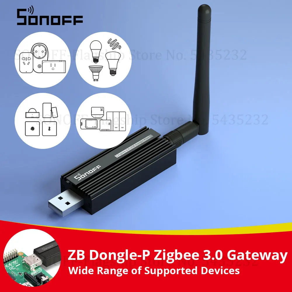

I was planning to buy
Are you saying I need an extra zigbee usb stick or Zigbee hub?
Noted.
That one will work fine.
I have the same, I needed to update the firmware to the latest, but been working without issues since.
Thanks can I know how old is your setup and is it reliable meaning do they need frequent fixing. I am asking this as I may move out of this house and my parents may not be able to fix them
The previous zwave stick was running for about 2-3 years…but did not survive my son stepping on it :slight_smile: . (you can see why.. it was from before there were nice usb versions everywhere available)
The sonoff is the much nicer replacement (might even survive my son stepping on it, as it has a sturdy metal housing)
