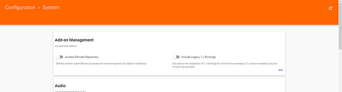

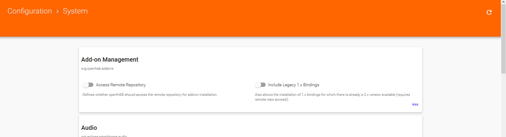

i “fixed” it by turning off the repo sync see here:
repo
no more stress on the server (from my side) =) guess it’s a bug in the addon sync function. I’m on the openHAB 2.3.0 Build #1248 snapshot. i’m not using openhabian.
