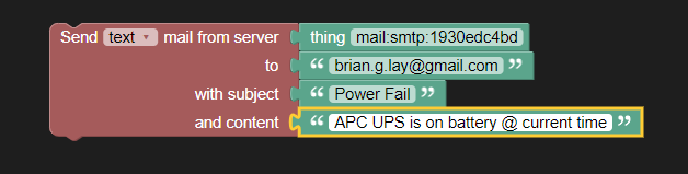

Creating a Blockly rule and I’d like to put the current time in the text of an email.
I know this is probably easy but how do I refer to the current time?

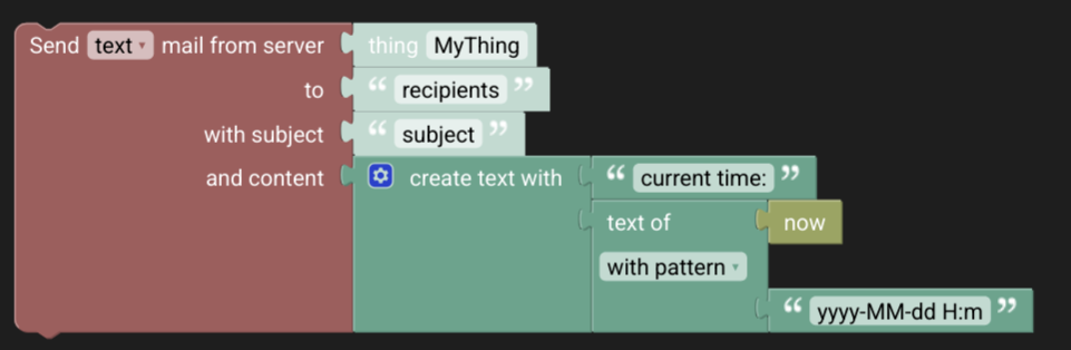

There are different options ![]()
One option should be Dates & Times → text of (now) with pattern (textpattern HH:MM)
text of is configurable, so you have to put now into the module and select with pattern from dropdown menu to get the option to setup the pattern.
