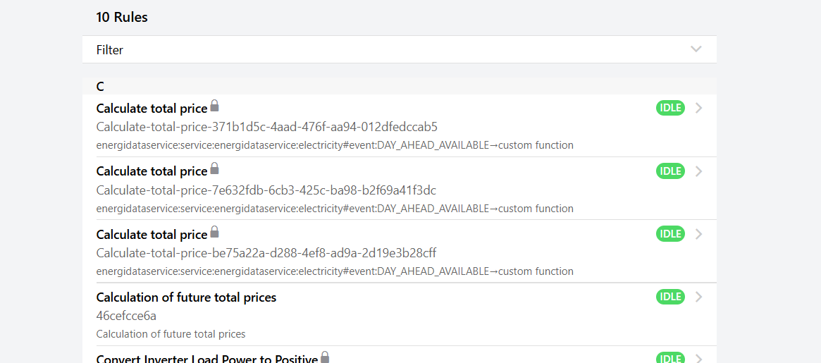

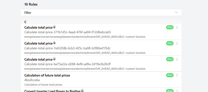

This is weird. I dont know if its suppose to do this or if it happens because I run the rule manually for testing purpose.
Everytime I run the “Calculation future total price”, then this rule creates a new rule named “Calculate total price”, without deleting the previous.
See screendump:
They´re locked, so I cant delete them.
But maybe this is suppose to happen?
The “Calculation of future total price” rle is the action JavaScript mentioned in the first post.

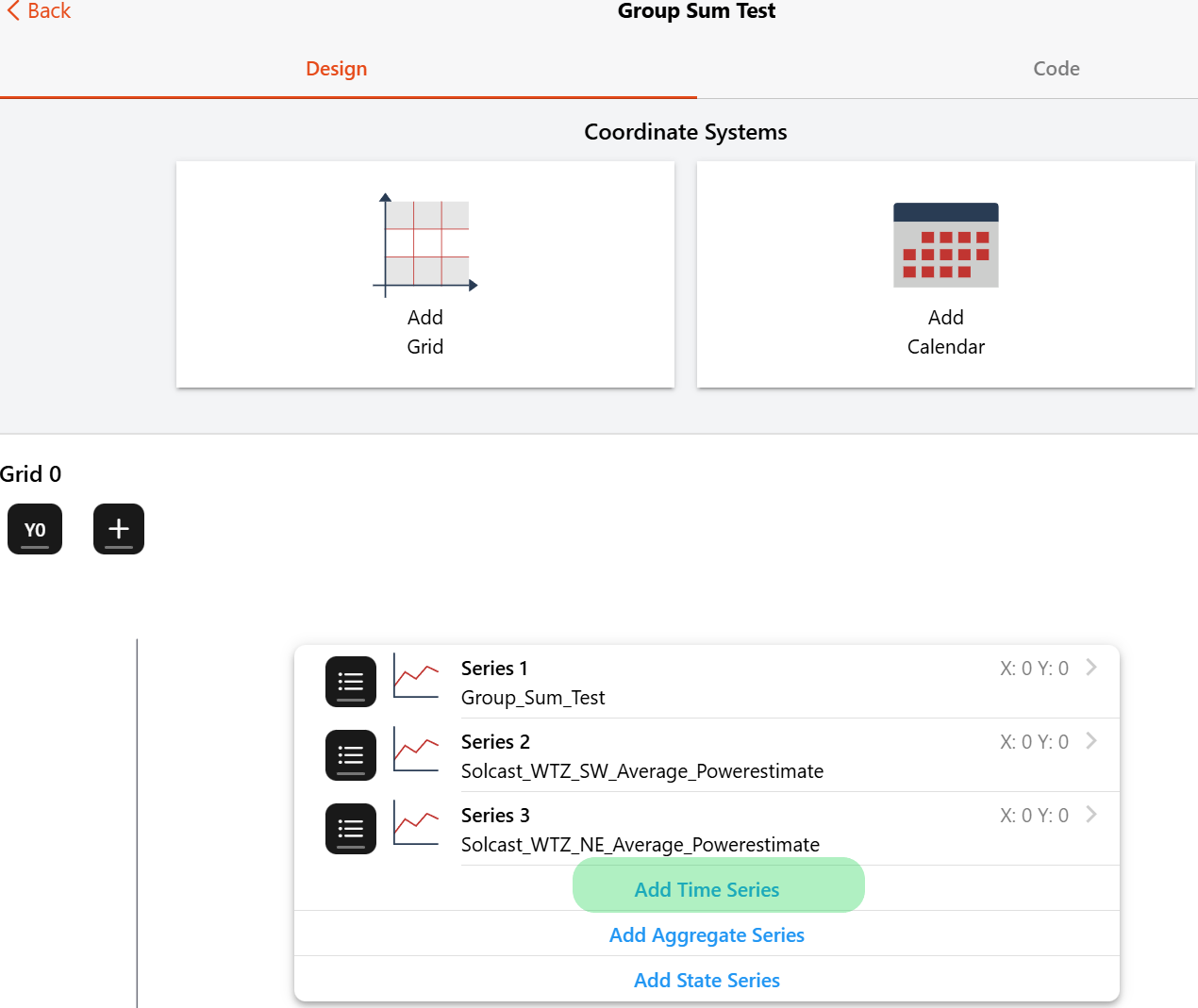

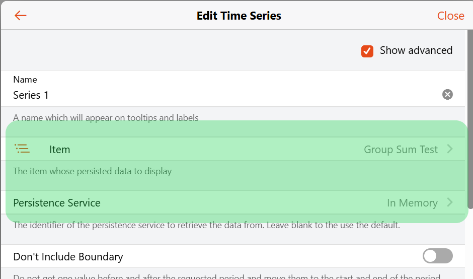

MainUI → Settings → Pages → Add Chart
Fill in the properties.
Add a Grid.

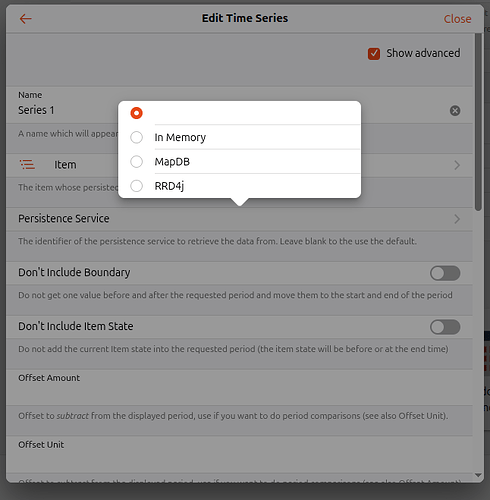

Add a timeseries to the Grid.

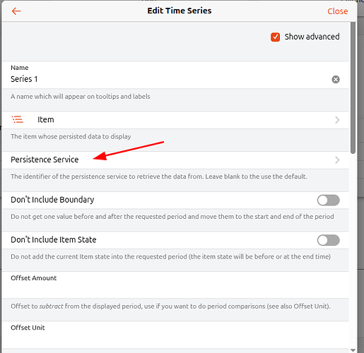

Click the black icon to configure the timeseries. Click “Show advanced”.

That’s weird. How are you running the rule manually? Is the entire contents of the file what you posted above? Or did you paste that JS code into a UI rule? If the latter, this is expected behavior because your UI rule is just creating a new rul;e every time it runs. That code above must be put in a .js file in $OH_CONF/automation/js same as any file based rule.

It seems like it has removed the other three weird rules in the scrrendump above, yet it did created a new one. I guess thats the purpose then.

No. It says right there it’s file based.
What you’ve done is creates a rule that creates a rule in the UI. So of course, every time you run it, a new rule appears.

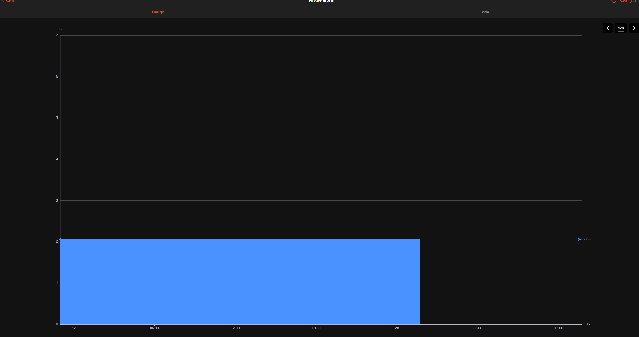

I have now spend the last few hours trying to get this to work. I created a chartpage, but the outcome looks like the persistens doesnt work.
I have no idea which item to query, (I assume its ‘totalprice’). But it just show a static value in the time-series. The binding doc isnt clear on this part, or how to get from the first javascript to the second rule, (which the javascript creates).
It seems to me the binding doc assume I already know something, which I dont. Or I dont get it..
Seems like Im stuck :frowning:

The chart still shows the static value 2.06 afterwards.
But from the log, I would say next step might be to get the rule to run, or wait untill aprox 13.00 o’clock today, where it should update itself.

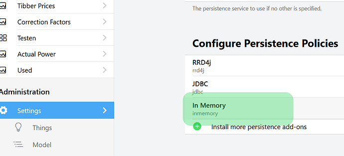

  • install inmemory persistence
  • remove your text config inmemory.persist
  • just to be sure: the items from top post are properly connected to enegridataservice thing?

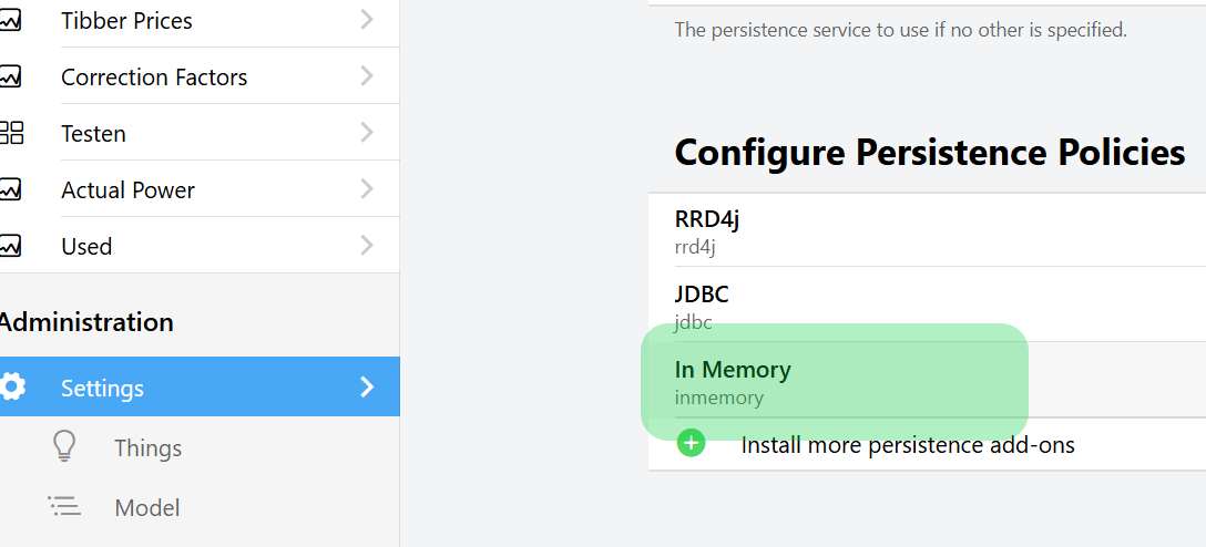

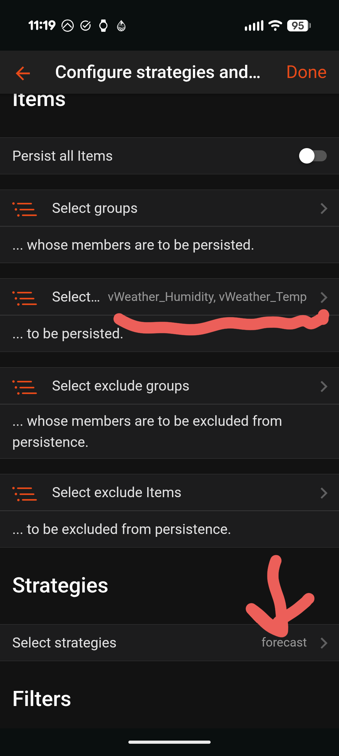

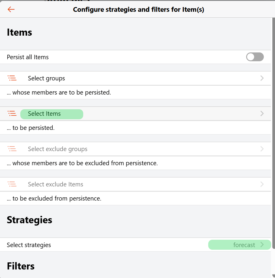

Persistence config
  • use the UI, not text config, at least for now

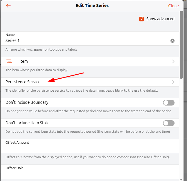

  • go to Adminstration - Settings - Persistence and select from Configure Persistence Policies - In Memory (picture 1)
  • you can remove existing policies if you wish
  • Add a new configuration and add your items from top post (picture 2)
  • don’t forget to save

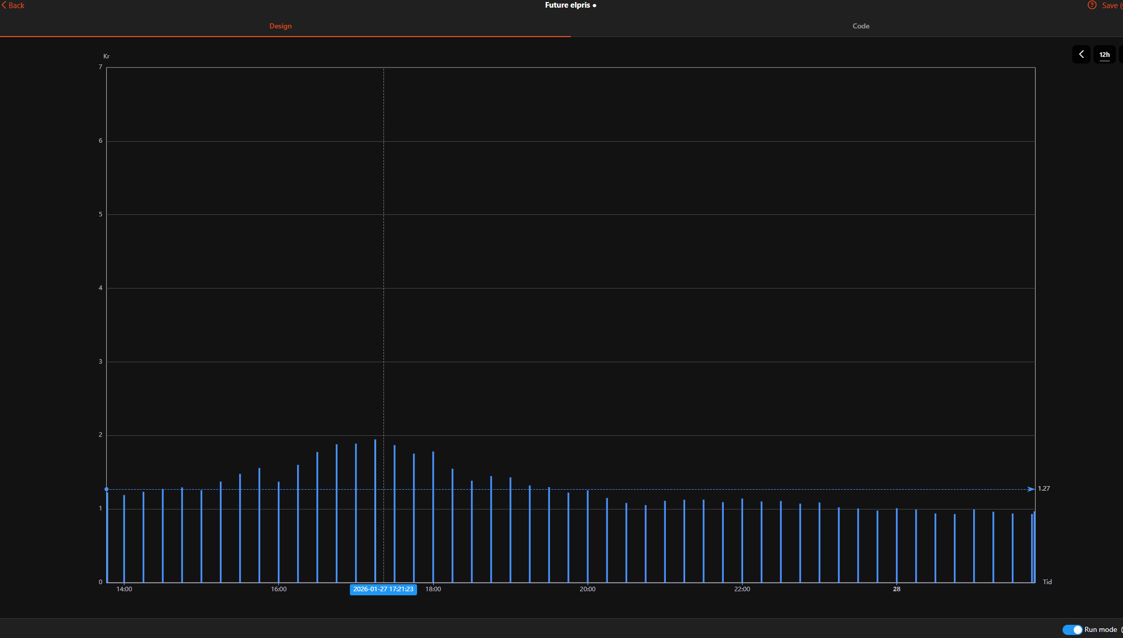

From now on the updates are stored in memory. But the price bindings are updating only once per day!
To force an update disable energidataservice thing and enable it again.

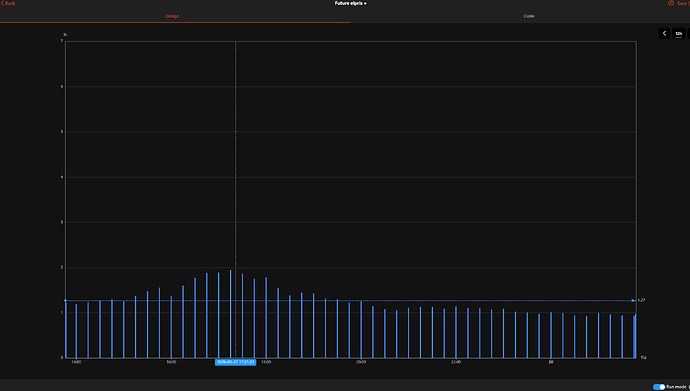

Graph
  • ensure the items showed in the graph are getting the data from the right persistence (picture 3)
Pic 1
Pic 2
Pic 3
  • done
  • done
  • done

This is the inmemory configuration:
configurations:
  - items:
      - ElectricityTax
      - GridTariff
      - SpotPrice
      - SystemTariff
      - TotalPrice
      - TransmissionGridTariff
    strategies:
      - forecast
    filters: []
aliases: {}
cronStrategies:
  - name: everyMinute
    cronExpression: 0 * * ? * *
  - name: everyHour
    cronExpression: 0 0 * * * ?
  - name: everyDay
    cronExpression: 0 0 0 * * ?
thresholdFilters: []
timeFilters: []
equalsFilters: []
includeFilters: []
I tried disable/enable the binding. All EnergiDataService items updates, except the ‘TotalPrice’.
Exactly which item is suppose to be entered in Pic 3 ??
EnergiDataService got 5 items, ‘Spotprice’, ‘GridTariff’, ‘SystemTariff’, ‘TransmissionTariff’ and ‘ElectricityTax’.
Beside that it got this ‘TotalPrice’ which is a sum of the 5 items. Which I believe is beeing updated through the rule?
’TotalPrice’ is the one I want to chart. So thats the item I have added in the chart setup (time-series) as well as specified inmemory persistens.

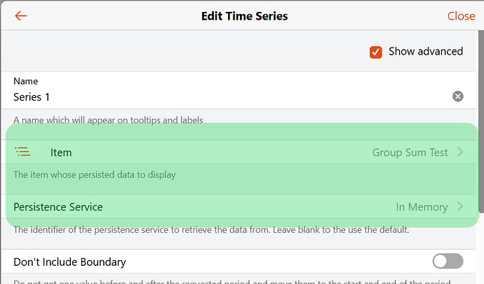

This is my chart/time-series setup:
onfig:
  label: Future elpris
  future: 1
  period: 12h
  grid:
    - component: oh-chart-grid
        show: true
  xAxis:
    - component: oh-time-axis
        gridIndex: 0
  yAxis:
    - component: oh-value-axis
        gridIndex: 0
        min: "0"
        max: "7"
  series:
    - component: oh-time-series
        gridIndex: 0
        xAxisIndex: 0
        yAxisIndex: 0
        type: bar
        item: TotalPrice
        service: inmemory
        markers:
          - avg
  visualMap: []
Am I doing this wrong?
This is the outcome, when I press the Run button in the chart page setup:
Its starting to get rather frustrating when any changes doesn seems to matter..
ARRRGH (sorry, some more frustration).
I just tried exchange the ‘TotalPrice’ in the time-series setup to use ‘SpotPrice’ insted. Thats all I did change. This is the outcome:
Now, this tells me item ‘SpotPrice’ is beeing persisted just fine, and the chart is working.
Im back to the item ‘TotalPrice’ which for some reason do not work.
Don’t get frustrated :slight_smile: You’re too fast and looking too much to the wanted result.
You successfully mastered to show the future values of the SpotPrice in the graph.
This is good!
All of them needs to be configured in inmemory persistence. This is 100% needed as pre-condition for your calculation!
Add all of them into the graph and all of them need to have proper values.
If this is done we can continue checking the rule!
What about the item totalPrice ?
Im lost here..
  • How do I add more than one item to the chart time-series?
  • And why?
I thought the binding rule would calculate each items and then write it to the totalPrice isnt that the purpose of the rule?
(If not, I have failed to understand this for sure, which may explain my frustration for sure).
Ok, let’s try to sort this out. Apoligize in beforehand for being nit picky :slight_smile:
  • the rule has nothing to do with the energidataservice binding. I mean literally nothing. Yes, it’s an example from the documentation how to calculate the total price but it’s not technically related to the binding.
  • the energidataservice binding only provides values which are forwarded to the items and then stored in the persistence
  • as rich explained rrd4j cannot store future values, that’s why inmemory persitence is needed and each item needs to connected to this persistence
  • the rule if you look a bit closer is just operating on items and add them up
Basically
binding –provides values–> item --storage in-> inmemory persistence
rule –using–> item –reading values–> from inmemory persistence
The graph is useful if the above configuration is correct!
The sum in the rule is the final step after the the above configuration is straight. It will not work without this config!
You already have a graph as shown above in your screenshot. Just scroll down in the and Add Time Series. Pick the item to display plus the Persistence service where the data shall be fetched from.
So I should add a time-series for each item?
Yes, so @weymann can verify that all your Items are configured correctly and are working with the binding. Once that’s confirmed you can start working on the rule to calculate the states for the totalCost Item.
