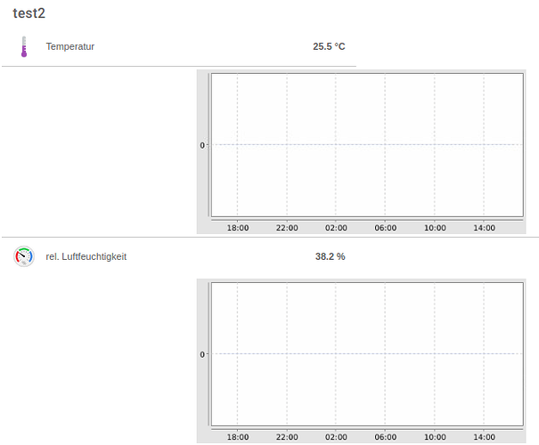

Show no data in my Chart Item

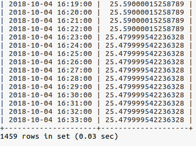

I have store my data in a mysql database and it works fine.
But there is no data in the Chart sitemap element:
The data are here in the database in the table Item1:

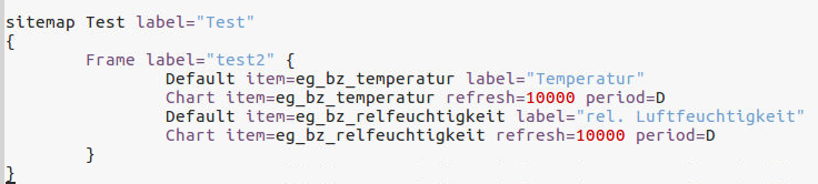

My sitemap is:
What could be the error?

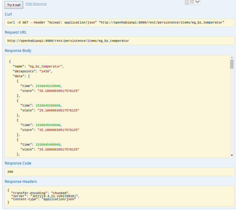

You did a check what is in the database directly, could you do the check using the REST API?
That way we could confirm that OH is able to pull data from your database.
I have read the doku to the REST API and have found this API call:
And I see, that he can read the values from the database.
Nevertheless, the values are not displayed in the chart !?
OK, with that!
I can spot no reason why the values should not be charted!

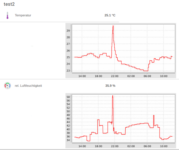

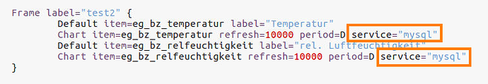

I have found the reason!
Although, I set the default persist value in PaperUI …
… the parameter service=“mysql” in the sitemap file is need …
… then the charts are drawing:
In that case you probably have more then the mysql as a persistence service running.
