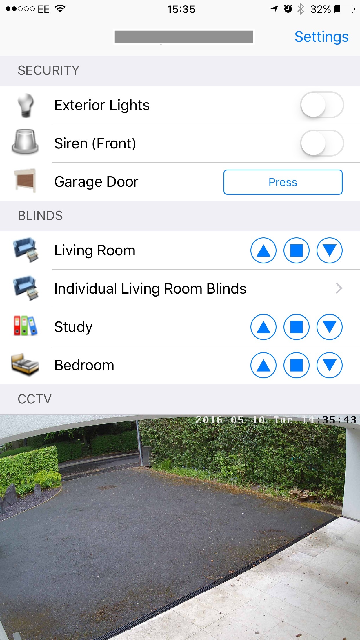

I have a Rollershutter in my items file, and when displayed via a Group declaration in the sitemap, it displays attractively with up, down and stop icons.
However, that means an extra tap to get to the screen showing the blinds group. How is it possible to display the rollershutter control on the home screen? I tried Switch which just showed a switch, and Rollershutter doesn’t seem to be supported in sitemap.
Thanks!

Ah yes, sorry. I was referring to the rollershutters via a group name, which doesn’t work. Looking good now! Thank you.
