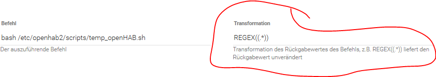

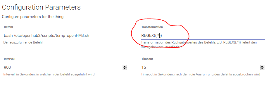

This is the configuration of my exec thing:
The exec transformation is installed but I don’t know what to write there.
And that’s what’s coming out of it right now:
I just can’t do it with the transformation. I’ve read through all of this, but I just can’t figure it out.

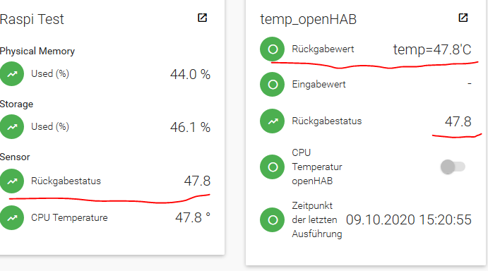

When the script is executed I get the following value back:
grafik
Of course, I would like to see this value as a “Number Item” in the return status.

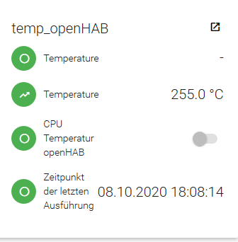

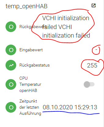

What I get is this error message with the return value. I was looking for a solution here and actually this error message should not trigger at all.
The input value always remains empty and the input status is always only 255.
Only the time of the last execution is displayed correctly.

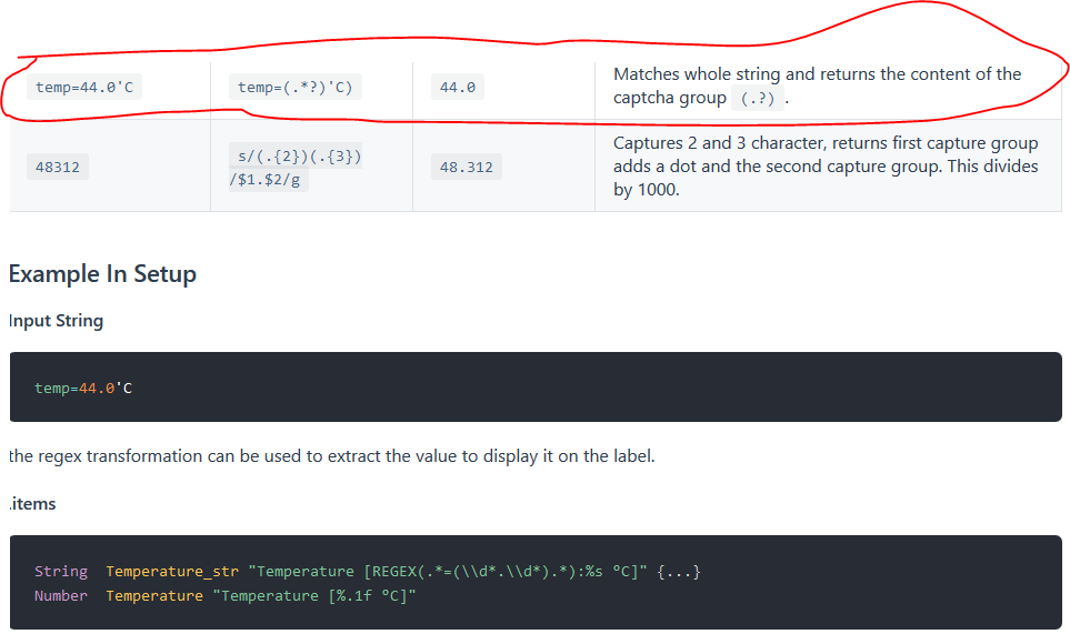

This is the example in the RegEX Transformation documentation and that is exactly what I want.
What is the input string and what content must it have? Unfortunately, this is not written for “dummies”, you know what i mean?
In the end, it’s all about the content of this line in the Exec Thing. What must be in there so that the output value is transformed correctly?
The result that I have assembled from the RegEx documentation now looks like this.
The solution is certainly very simple, but unfortunately the documentation is not.
Best regards
I think the setup is not correct yet.
The exit status / Rueckgabestatus 255 indicates that there is a problem with the execution of a script / binary. Normally the exit status 0 indicates that everything is ok.
Message about VCHI Initialization failed means that the command does not run correct. See e.g. VCHI initialization failed Raspberry Pi Fixed – The Chewett blog
The error message is only output in openHAB via the return value. I had already checked everything.
I get the 255 return status when I query the temperature with vcgencmd measure_temp.
I get the return status 0 when I measure the temperature with vcgencmd measure_temp | sed ‘s / temp = //’ | sed “s / 'C //” query and then strangely enough the error message also disappears in the return value.

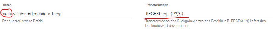

After a lot of reading and searching I have now made it work.
The solution is very simple. Use sudo to issue the command and choose the correct transformation. Like this:
Then follow the example in the RegEx documentation and in the end everyone will be happy.
I now get the correct return value and can convert it to the return status using a rule and then link it to the system info binding.
Thanks for your help
