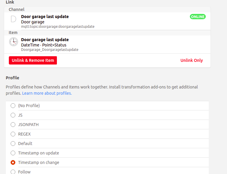

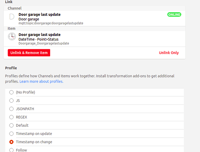

The timestamp is not inherently stored anywhere the UI has easy access to; the simple solution to this is a secondary item and the timestamp profile:
Create a secondary item like JustinG said:
Select Timestamp on update or Timestamp on change.

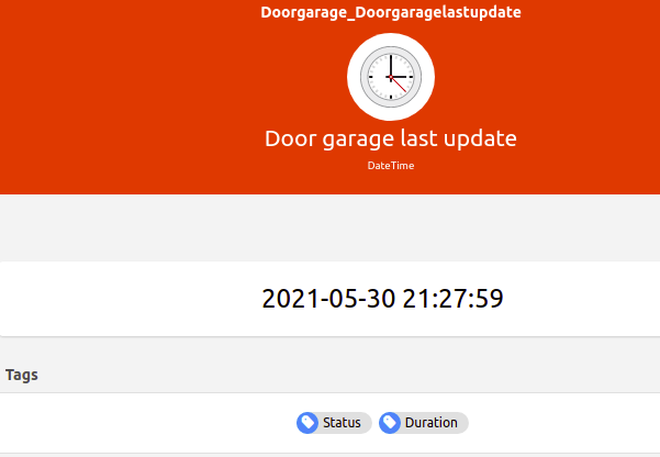

Then in the main UI card the code to display the formatted date for example is:
=items.Doorgarage_Doorgaragelastupdate.displayState
It will show up in the properties in OH3 if you assign the properties:
