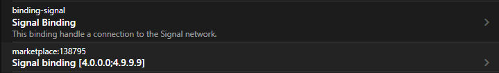

I finally managed to make another version, with a dedicated and proper dependency management for sqlite (it’s now a KAR file with start order for bundle).
I hope that it can fix your issue. If you test it, I would be glad to have feedback..
The link is updated in the open post. And so in the marketplace. As usual, remove and reinstall.
WARNING : this version is targeting openHAB 4 and won’t work on openHAB 3.
I hope that no one use it anymore, as I won’t be able to provide new release for it (maintaining a java 11 branch for the upstream signal-cli demands to much time).

I am currently moving my setup to a new machine. I am using Docker to virtualize openhab.
However I am currently facing two major problems while trying to get the signal binding to work.
My first problem is that for some reason the signal binding is showing up twice in the “add thing” dialogue. As you can see in the following picture.
My second problem occurs when I create a linked account thing with all the necessary data and scan the QR code with my signal account. After scanning the status of the thing says:
NonSuccessfulResponseCodeException - [405] Bad response: 405 : {"code":405,"message":"HTTP 405 Method Not Allowed"}
I really hope you can help me since I really enjoyed using the binding on my old instance and I am looking forward to using it in the future on my new one as well.
Thank you in advance :slight_smile:
This was due to a change in the signal server. The signal-cli library latest version fixed this, and I uploaded a new version (BETA 6). Can you remove the old one and reinstall from the marketplace ?

I reinstalled the binding and created a new linked device thing and it worked. Thank you very much for fixing the problem this fast.
The Problem with the binding being displayed two times is also solved although the description for the binding is gone. But thats not a functional problem so it’s fine.
Again thank you very much for patching :slight_smile:
