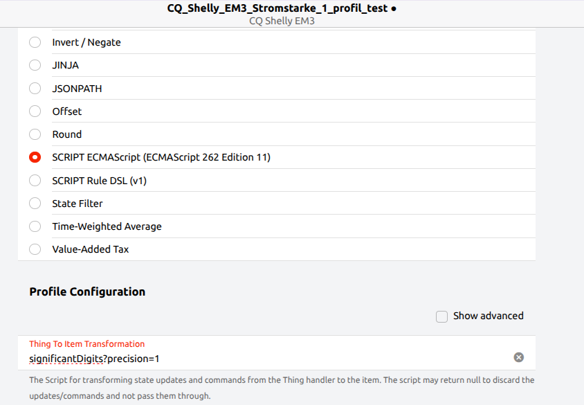

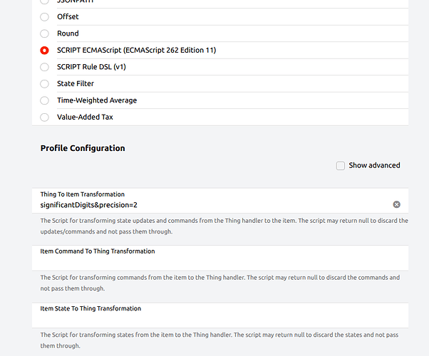

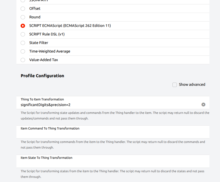

what is the syntax when using the MainUI and the field “Thing To Item Transformation” in the profile section in stead of the item-configuration in a file?
significantDigits&precision=2
Thanks! The docs were wrong, it should be written with an ?:
config:js:significantDigits?precision=1

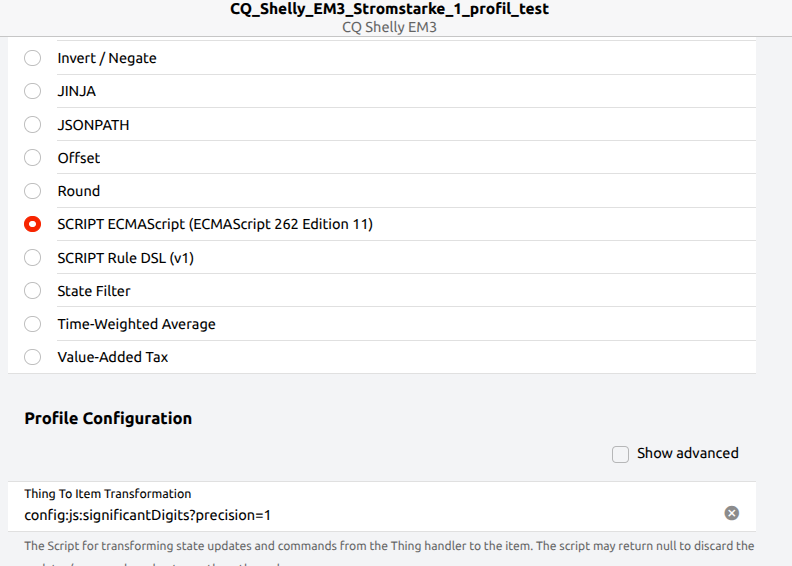

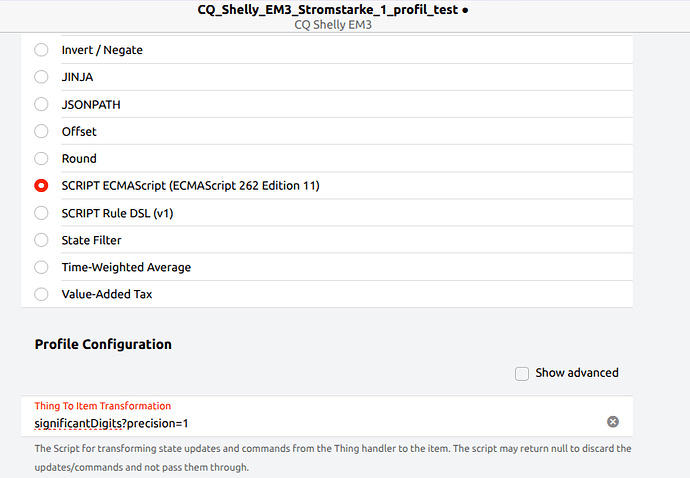

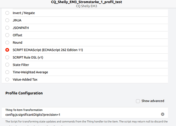

when I write
In MainUI item-config
I get this error in the log:
2026-07-29 06:30:58.741 [ERROR] [.module.script.profile.ScriptProfile] - Failed to process script ‘config:js:significantDigits?precision=1’ in link ‘CQ_Shelly_EM3_Stromstarke_1_profil_test → shelly:shellyem3:688271d27d:meter1#current’: Could not get script for UID ‘config:js:significantDigits’.
When I only write
2026-07-29 06:39:44.820 [ERROR] [.module.script.profile.ScriptProfile] - Failed to process script ‘significantDigits?precision=1’ in link ‘CQ_Shelly_EM3_Stromstarke_1_profil_test → shelly:shellyem3:688271d27d:meter1#current’: Could not get script for UID ‘significantDigits’.

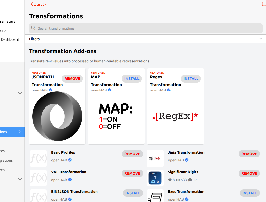

Even though “Significant Digits” is installed and shown in the Add-on Store section of MainUI,
I cannot find it in the list of installed Add-on bundles in the console:
