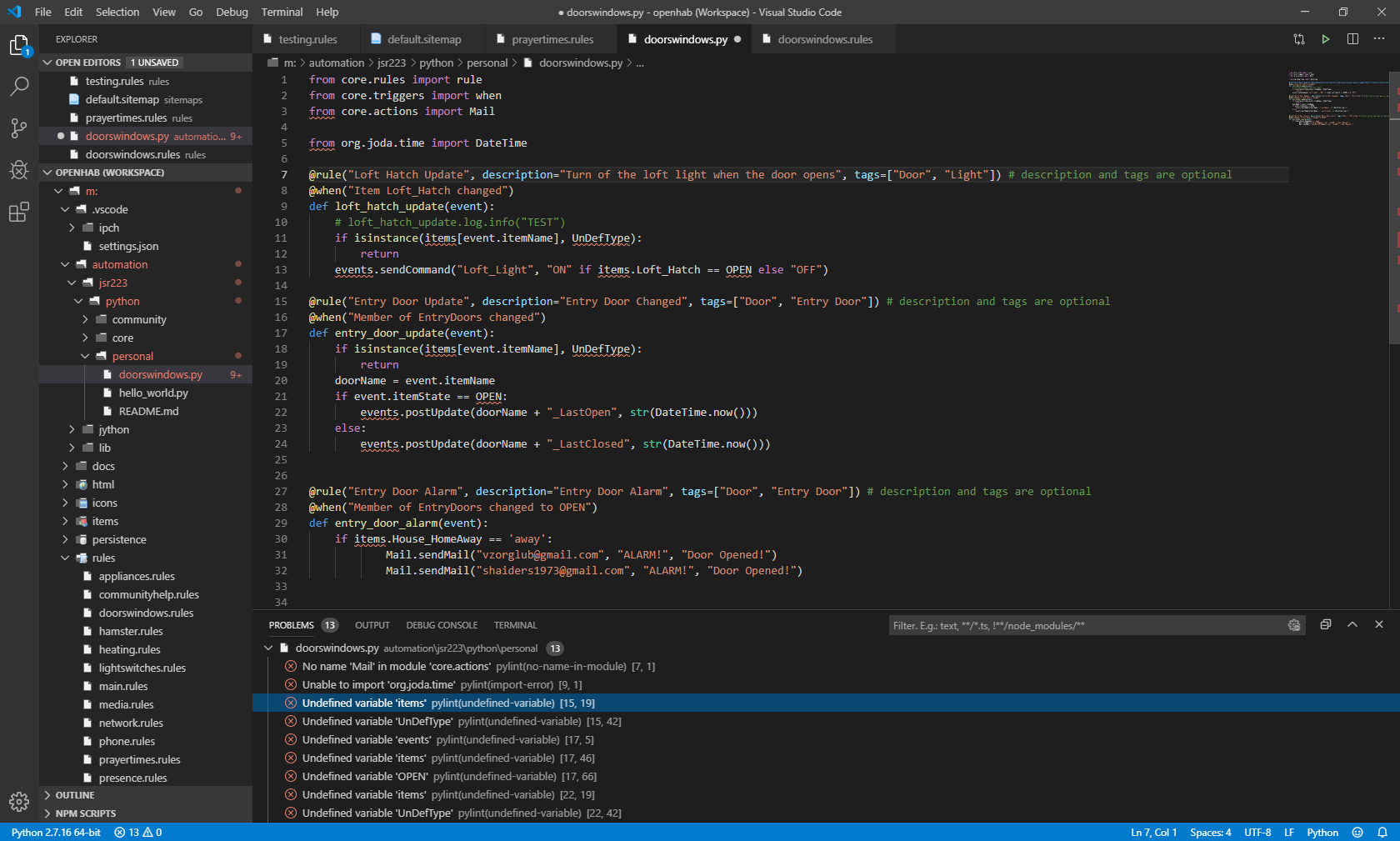

Nice! Running this through pylint would help with some cleanup. If you submit it as a PR, this would fit nicely into core.utils.
That’s kind! Although sadly I have no idea how to use pylint or make a PR… I will look into it!
Adding to GH is easy through the web UI. Just open the file for editing, paste in your code, and save to new branch (be sure to sign the commit). If you’re not comfortable using GitHub, I can add it in. I can also document the steps too.
