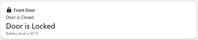

This is a simple widget. This is a door status card. The features include:
  • Fully Responsive (based on oh-label-cell)
  • Icons based on state

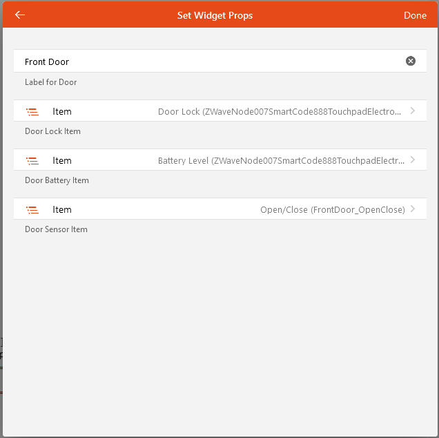

  • Configuration is simple and allows for an external sensor
    • The parts of label are separate properties to allow all locks
    • Allows for a sensor in addition to lock
  • Background color updates based on state

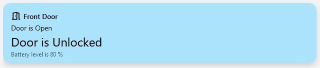

I’d really appreciate if you could add the ability to toggle the lock. I tried (yes, newbie here) to add actions to allow this but I’m just not understanding (yet) how these widgets work.
  action: toggle
  actionCommand: ON
  actionCommandAlt: OFF
  actionItem: =props.lock
Much appreciated ..
These actions fixed it .. Hope others find this useful .. Thanks again for the widget, love it ..

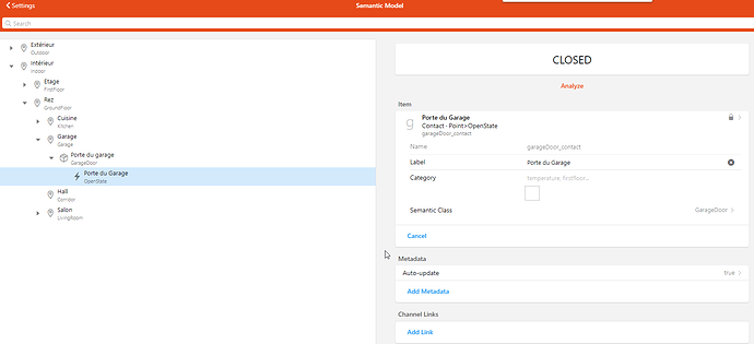

I want to display my garage door status but I don’t have an actual garage door item. I use a dummy item
Contact     garageDoor_contact       "Porte du Garage"                  (gGarageDoor)    ["GarageDoor", "OpenState"]    {autoupdate="true"}
I have a rule that updates that item’s status. So in my model, I can see my door status changing and I guess it’s good enough but I’m still not sure.

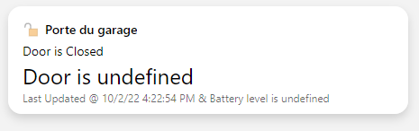

Right now what I was able to achieve is this :
I cannot remove the “Door is undefined”, also, I tried to change the footer text (I don’t need the battery level, my contact is hardwired) but it’s not reflected in the widget. Here is my yaml code :
component: widget:door_lock_status
  updated: garageDoorLastUpdate
  label: Porte du garage
  footer: = "Last Updated " + dayjs(items[props.updated].state).format("DD/MM/YY
    hh:m:ss")
  sensor: garageDoor_contact
slots: null
What am I missing?
I tried adding “lock: garageDoor_contact” in the configuration but no difference.
Any help is appreciated.
So two things. It looks like you have the version 1 code for the widget vs 1.1 (lastest) not sure how you go that but the problem with seeing door is twice was fixed then. The widget was originally made for things like zwave locks and I did not think about garage doors. The footer text currently is non-hidable. But I could add that in an update. That way if parts of the footer are valid it hides them.

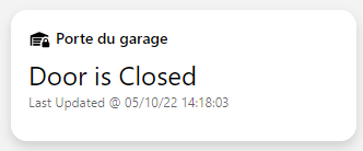

Ok so I got the code by installing the widget from marketplace.
I edited it with the code found here and then I altered it a bit more to suit my needs :wink:
So it’s starting to look more like what I need.
Thank you.
Glad you got something you like. I have had my real job pushing deadlines so I had to pause on my contributions here. Trying to remain active on the forums for help though. FYI on all my widgets there are snippets of each version and a “latest”. The latest is always the latest as it is the one karaf (marketplace) keys on since it is a raw yaml file. If you want to share code at any point for me integrate into my widget for all just DM me it and ill work on it.
I understand and thank you for your time.
I don’t think my modifications are worth sharing as I merely removed some stuff (battery and lock I don’t have). It’s the first time I’m trying to do something with widgets but if I do something better later on, I will share. :slight_smile:
