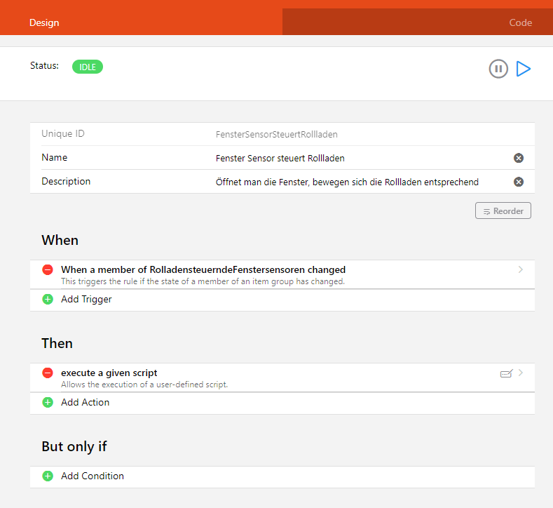

Simple ECMA script to control rollershutter with window sensor
When I open the window (or door) that has roller shutters down, I want that roller shutter to go up. And when I close, it should go back to where it was. In Germany, we have a 3rd state (“Gekippt”-“Tilted”).
Not rocket sience here, but as I am new to javascript and syntax, I thought this might help someone get started.

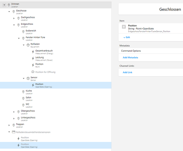

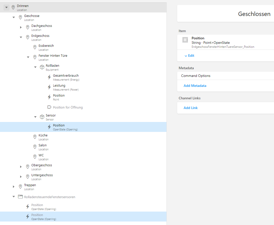

Model is:
important items:
i have non-semantic group with all the window sensors and a non-semantic item that remembers the last position of the roller shutter.

it is important to double check the naming on the items → I use a “replace” function to link the sensor item (that triggers the rule) to the rollershutter item that change the pysical position.
ErdgeschossFensterHintenTuereSensor_Position
ErdgeschossFensterHintenTuereRollladen_Position
That’s it.
