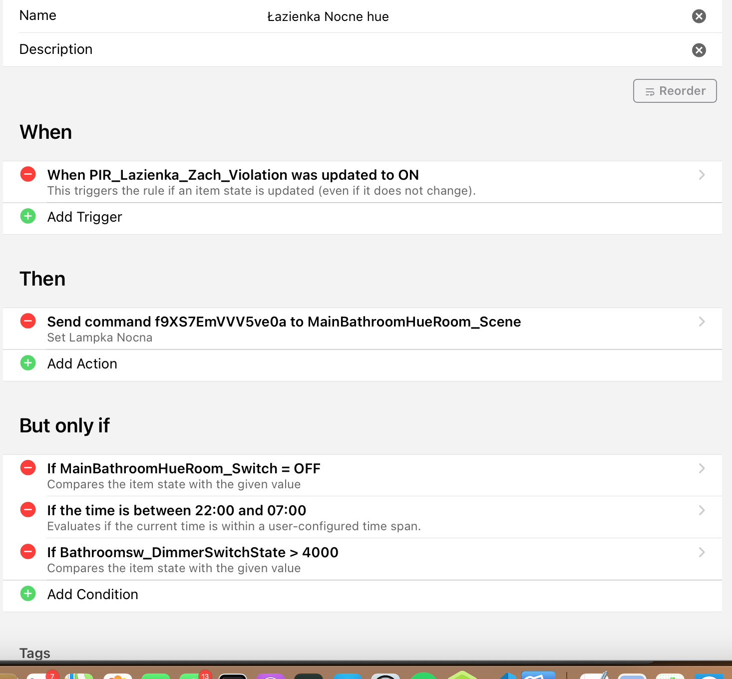

I’ve made it, but it wasn’t as straightforward as I anticipated ¯\(ツ)/¯
First of all I created “virtual” switch which acted as a proxy for Satel PIR - Occupancy_Bath with metadata expiration timer 5 min and OFF command.
next was creating rule which actually turned on predefined hue scene (f9XS7EmVVV5ve0a) in bathroom, but only if light wasn’t ON manually and time of the day was between 10pm and 7am
problem was that ccupancy_Bath switch with metadata expiration timer doesn’t turned hue off by itself [don’t know why, yet], so next rule was to turn of hue
You have to put the expire on the light. The rule triggers on the motion to turn on the light. Repeated motion commands the light on again, restarting the expire. Only sheet 5 minutes of no on commands with the light turn off.
In short, put the expire meadata. on your light items, not the occupancy item.
Yes, finally I did it this way, but I’ve tried more sophisticated solution. My plan was to turn night scene in night only, and light expiring only if it was turned by PIR sensor, not expiring if it was turned on by hand. AND also not to change scene if the light was already turned on. I planned to create special scene for that, and set expiry metadata on it, but it seems that sending OFF command to scene by expiry metadata doesn’t turn off light actually. Also creating separate expiring item switch from thing channel does’t worked as this new separate item turns on along with other item created on that particular channel ¯\(ツ)/¯
So finally my working rule is like that
expiring light switch, not scene, as command turning OFF don’t worked for scene
Let’s take a step back. Expire only works on the single Item that it is configured on. So if you have it configured on Item Foo, then Foo will receive the command OFF when Expire goes off. If you need to cause other items to change states too, you will need to write a Rule that triggers when Foo goes OFF and sends the commands to the other Items.
I’m glad you got it working in the end. It’s not as important for this particular rule, but it will be good to get in the habit of posting the actual code instead of screen shots. Screen shots usually do not capture everything on needs. There is a code tab at the top of that page. Paste that text into the post and use code fences to preserve the indentation.
