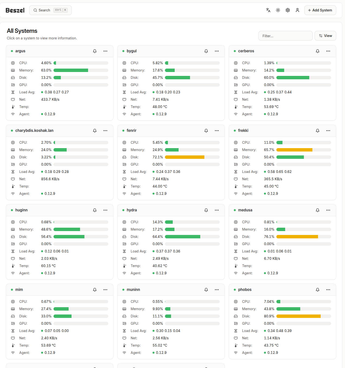

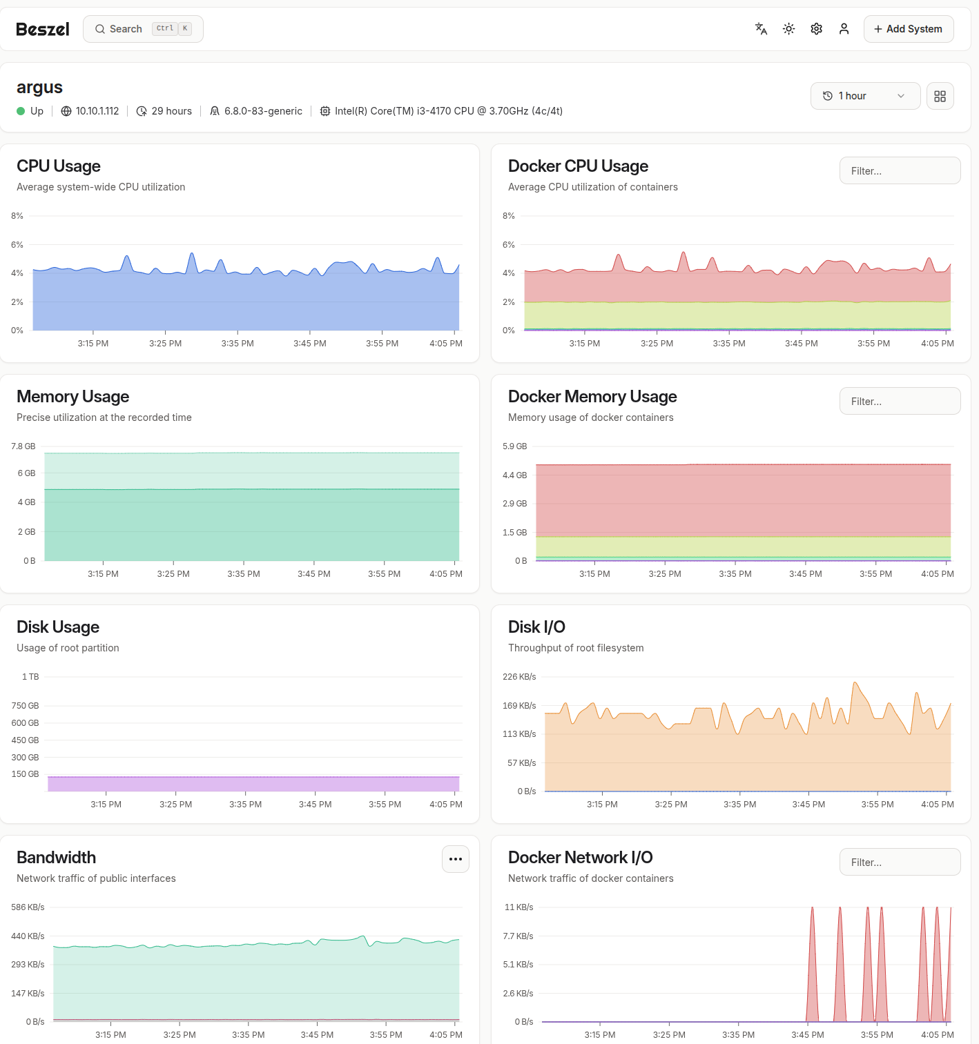

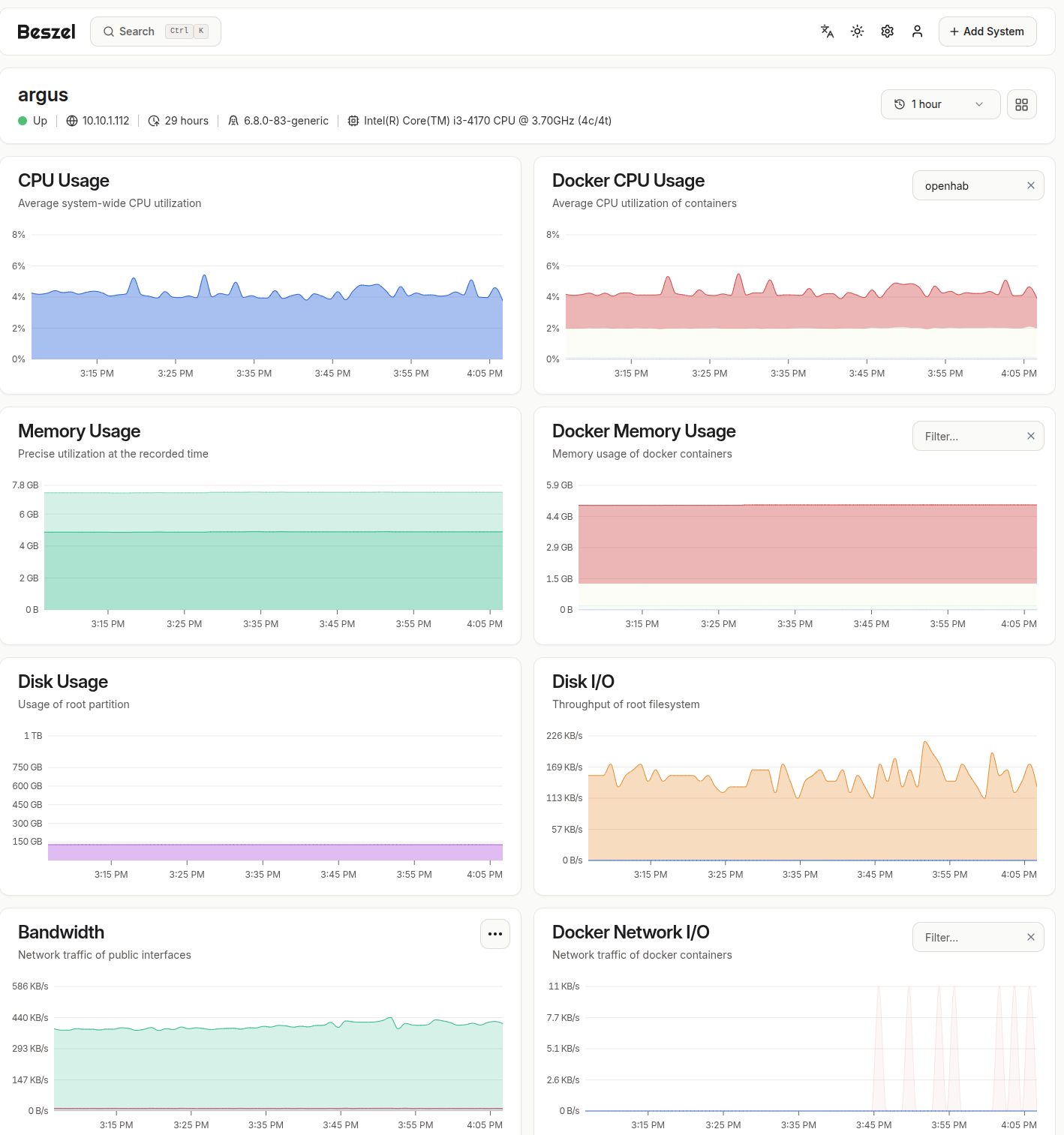

I got the whole thing set up in under an hour. Some screen shots:
You can set up alerts through lots of different services. Unfortunately you cannot set up an alert for when a specific Docker container goes down. But given the amount of effort spent to set this up that’s a minor missing feature.
