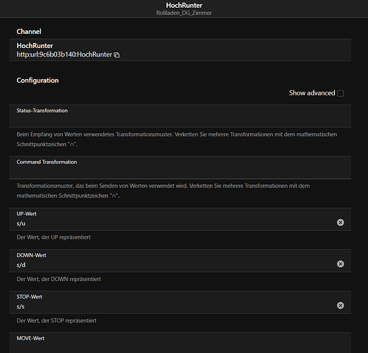

1. Create a HTTP URL Thing
As base URL I entered http://[LocalIP]/
2. Create a channel in the HTTP URL Thing
In that thing I created a “Rollershutter channel”
Status and command transformation I left empty
as “Up” Value I set “s/u” → Becaue in my browser the URL request http://[LocalIP]/s/u made the shutter move up.
For Down I set “s/d”
Für Stop I set “s/s”
Move I left empty since there was no matching parameter.
3. The channel I connected to an Rollershutter point Item.
In OpenHAB everything looks good. The thing is online.
But when I click in the arrow up in the item, nothing happens.
What is wrong here? I have no idea where my mistake is.

I assume “u” is the command for “UP”. In this case the base url is:
http://[LocalIP]/s/%2$s
UP value: u
DOWN value: d
STOP value: s
However, I do not know where to enter these data. Your screenshot also looks different fron the one I was linking to. Your http binding provides you probably with several ways to get things done.

In the meantime I swiched to textual configuration of openhab. Nevertheless, your hind was very valuable and helped to configure the http thing correctly:
Thing http:url:ShutterOGZi "Shutter-OG-Zi" [ baseURL="http://192.168.1.35/s", refresh=1] {
    Channels:
         Type rollershutter : Steuerung "Steuerung" [ commandExtension="%2$s", upValue="u", downValue="d", stopValue="s", stateTransformation="JSONPATH($.shutter:currentPos:position)" ]
