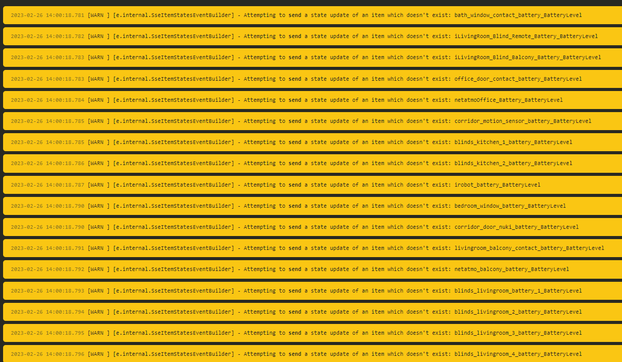

I wanted to try this out but it doesn’t show any low battery entries.
If I set the"group" of battery items I get following info in the log file:
The widget will not show any entries.

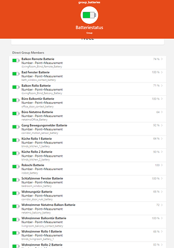

And this is the group of battery items:
