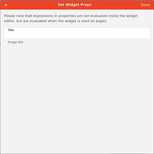

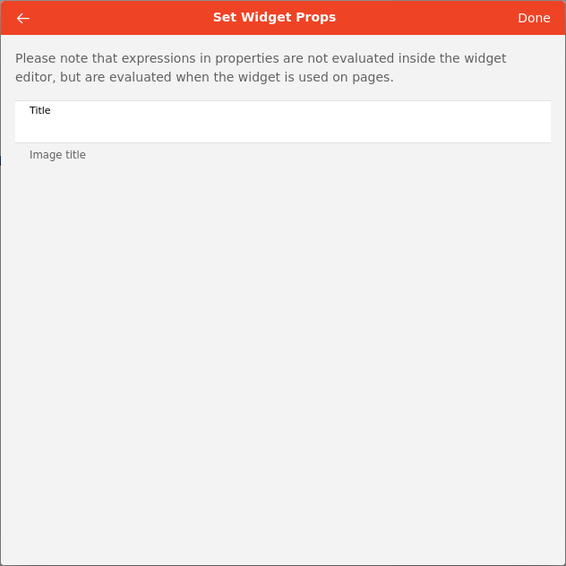

There’s one just one issue that you should be aware of. You define the prop title in the widget’s header area but you do no define the prop name. Why does the widget still work? Well, the widgets will accept and use any property that gets passed to them by the configuration that calls them so you can call your widget with the yaml:
component: widget:jb_image_list
    title: Some title
and it will work just fine.
What’s the point of the props: -> parameters part of the definition then? Those let OH make the property dialog boxes that allow users to configure widgets via the UI instead of yaml, and your widget will not have an input for the name property. It just shows this:
If you wish to be able to configure it with UI dialogs or want to make it available for others, then you should go back and add the full set of used props at the top.
