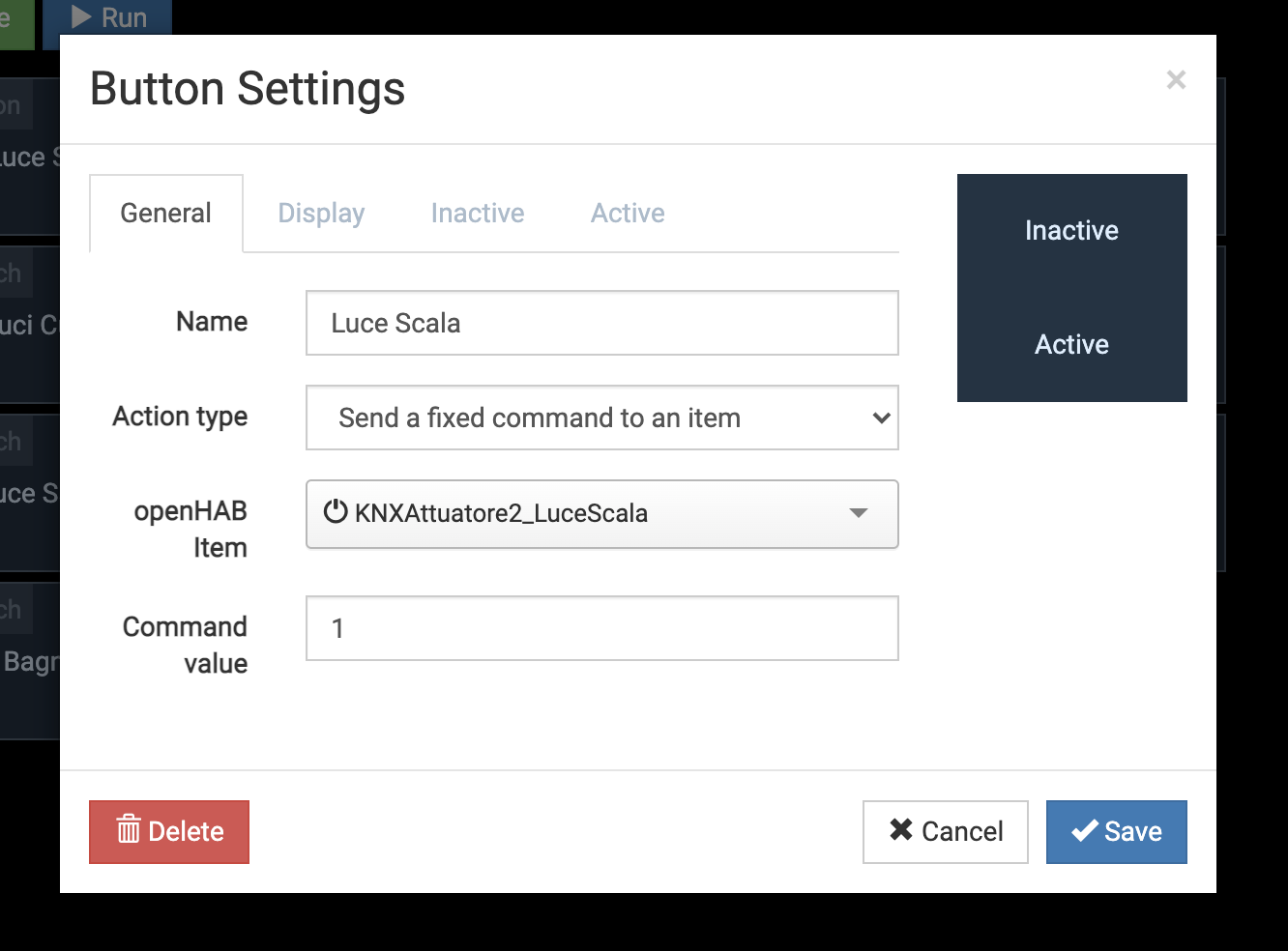

I’m moving from OH2 & files configuration to OH3 and UI generation of Items (keeping Things on files, at the moment..).
I need to have a simple button to click to send a 1 to a KNX channel and switch on a timed staircase. No state feedback, when I release, it should send a 0 to the channel.
On Habpanel it was easy:
But now I want to create an Item in OH3 (from main UI) to have it in web cards and in Habpanel too…
Please help..
