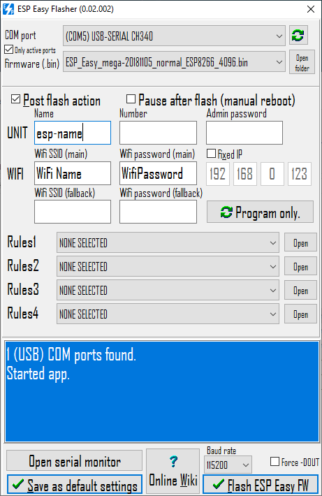

I’ve got nearly 30 of them throughout the house, and they all run ESPEasy - it’s a case of plugging the device in, running the ESP.Easy.Flasher tool, selecting a couple of options, and away you go.
