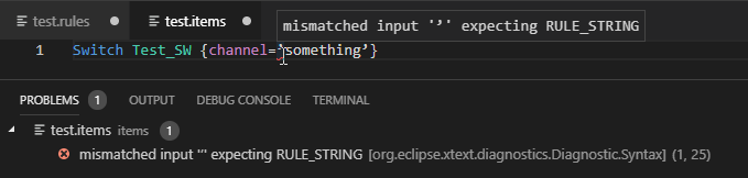

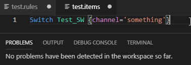

strange… if you use ’ (normal apostrophe)
it screams:
if you use ' (typewriter apostrophe) it doesn’t scream :slight_smile:
both are wrong of course :slight_smile:
