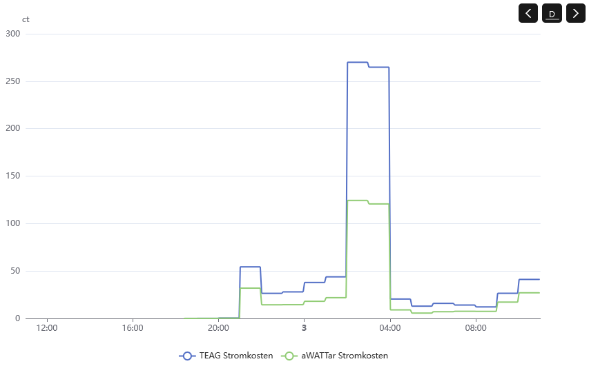

Hah! I just installed the aWATTar binding. As there’s no need for a API-token ATM, it worked ootb. So now I can simulate. At least the last 20hours or so, the Marketprice was cheaper than my fixed rate from the EVU. :wink:
