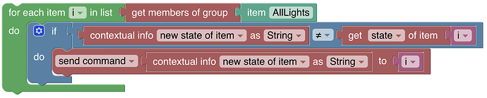

In JS in the UI the action script would look something like this:
It’s really just a one liner. But the subtlety that makes it work is in the rule trigger and that you only send a command to Items that are not already in the same state. If you used received command or received update or just send the command to all the Items it wouldn’t work and you’s likely get into a loop or at a minimum trigger the rule a bunch more times than necessary.

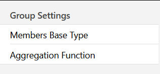

Oh the group function. No, the group function is irrelevant. The group function is only used to update the group's state. In the rules above, we’re dealing directly with the group’s members, and not using/checking the group’s state at all. So you don’t need to have any group function and just have a plain simple group.
