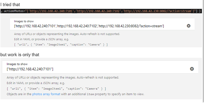

- Issue of the topic: Single quotes are not processed in processing in metadata (oh-list-item).
I set up using the file method and in the description inside the metadata I can only use single quotes.
But the metadata itself does not accept single quotes, only double quotes.
If you describe the methodology with double quotes and close with single quotes, then the construction collapses and I lose the model as a whole.
And when I use it the other way around, then single quotes are written inside the metadata and the widget stops working
p.s. configuring via gui is not acceptable
