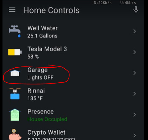

Is it possible to create a Text block in a sitemap that will have a different label name based on the visibility feature?
Take this for an example, if my light timer is reported with a “0” it displays “[Lights OFF]”, if my light timer is >0 it displays how long till the lights go off: “[7 min]” like this:

You are on the right track. If you want to see a different element in your sitemap depending on the state of an Item, you’ll need to create a separate element and set the visibility to the one element you want to see based on the state of the Item.
I used to do this with my garage door opener when I used to use sitemaps. I’d have one element with a button lableed “Close” when the door was OPEN and another labeled “Open” when the garage was closed.
The element commanded the opener Item but visibility was determined by the sensor Item.
