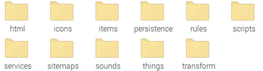

silv
(Sofiane)
November 5, 2020, 12:35pm
11
I dont have the conf foalder in oh2
silv
(Sofiane)
November 5, 2020, 12:39pm
12
It actually exists and I already worked with OH2 on a VM raspberry. This is the first time the UI cannot find my sitemap
