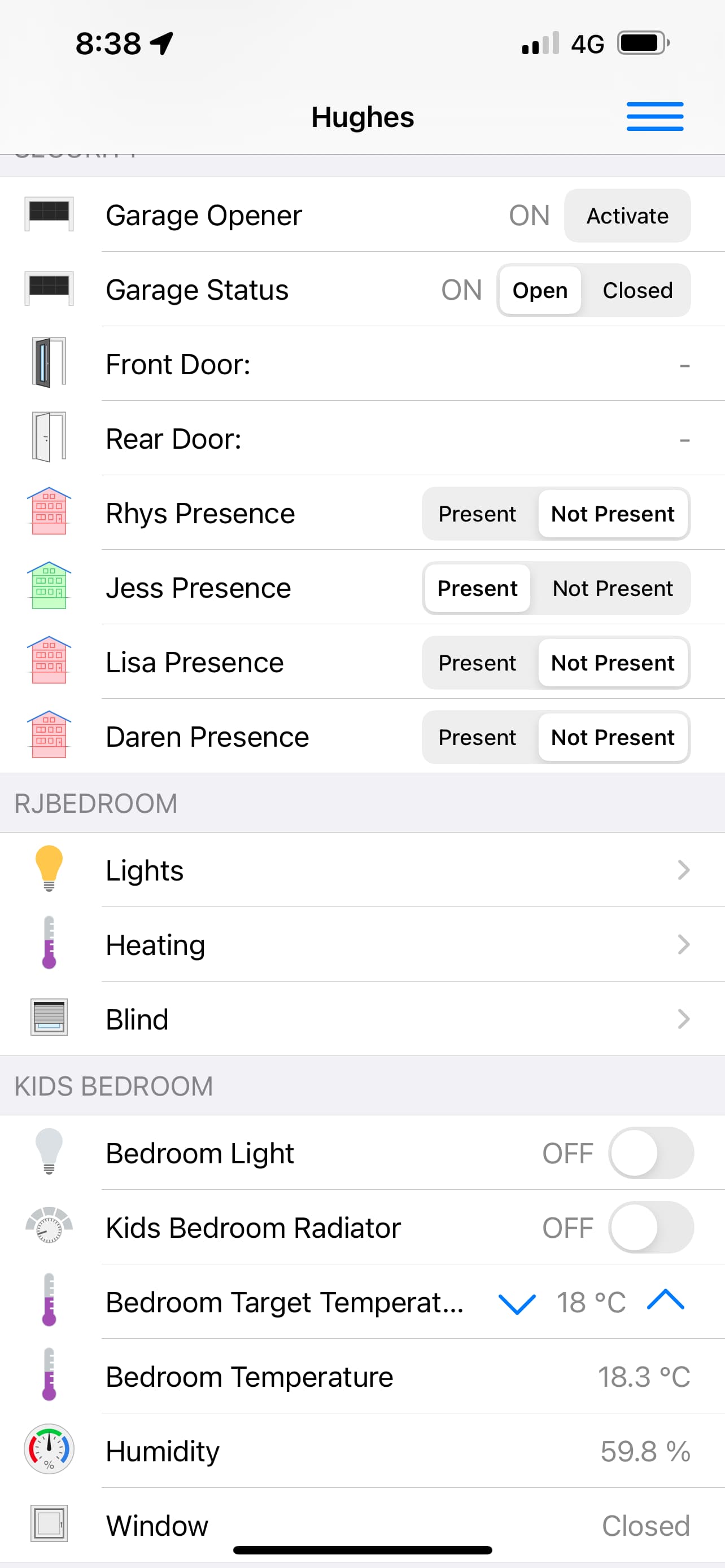

Good Morning, recently I have started to try and clean up my sitemap as it was taking to much scrolling to get to the bottom items! So I condensed the RJBedroom frame into sub menus. Like so
I am now trying to create multiple submenus in the Lights menu so I can tidy this section up into the
Bedroom light item
Both lamp items in a submenu
And led controls in a menu.
This is my current setup for that frame I’m just not sure how to code the submenus in a submenu!

Yes I did try that and the site map wouldn’t load. On the app. So I presume my syntax was wrong. I’ll try again working of what you’ve suggested and let you know.
Working perfect thank you. From what I can see I think I missed of 1 of the closing brackets!
