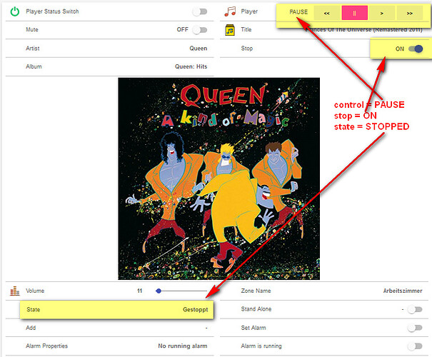

I don’t think that it will work with an item that is linked to your “current album”-channel. Even if your Sonos stops, the name of the last album will be held in the items state.
Maybe a better solution could be an item like one of those:
Player AZ_Sonos_Control   "Player[%s]"  <music>        (AZ_Sonos) {channel="sonos:PLAY1:RINCON_xxxxxxxx:control", autoupdate="false"}
Switch AZ_Sonos_Stop      "Stop[%s]"    <sonos_stop>   (AZ_Sonos) {channel="sonos:PLAY1:RINCON_xxxxxxxx:stop", autoupdate="false"}
String AZ_Sonos_State     "State [%s]"  <sonos_state>  (AZ_Sonos) {channel="sonos:PLAY1:RINCON_xxxxxxxx:state", autoupdate="false"}
When your player isn’t in use then
control is PAUSE
stop is ON
state is STOPPED
so if you have one of those channels you can handle your the visibility with it’s item-states in your sitemap.
