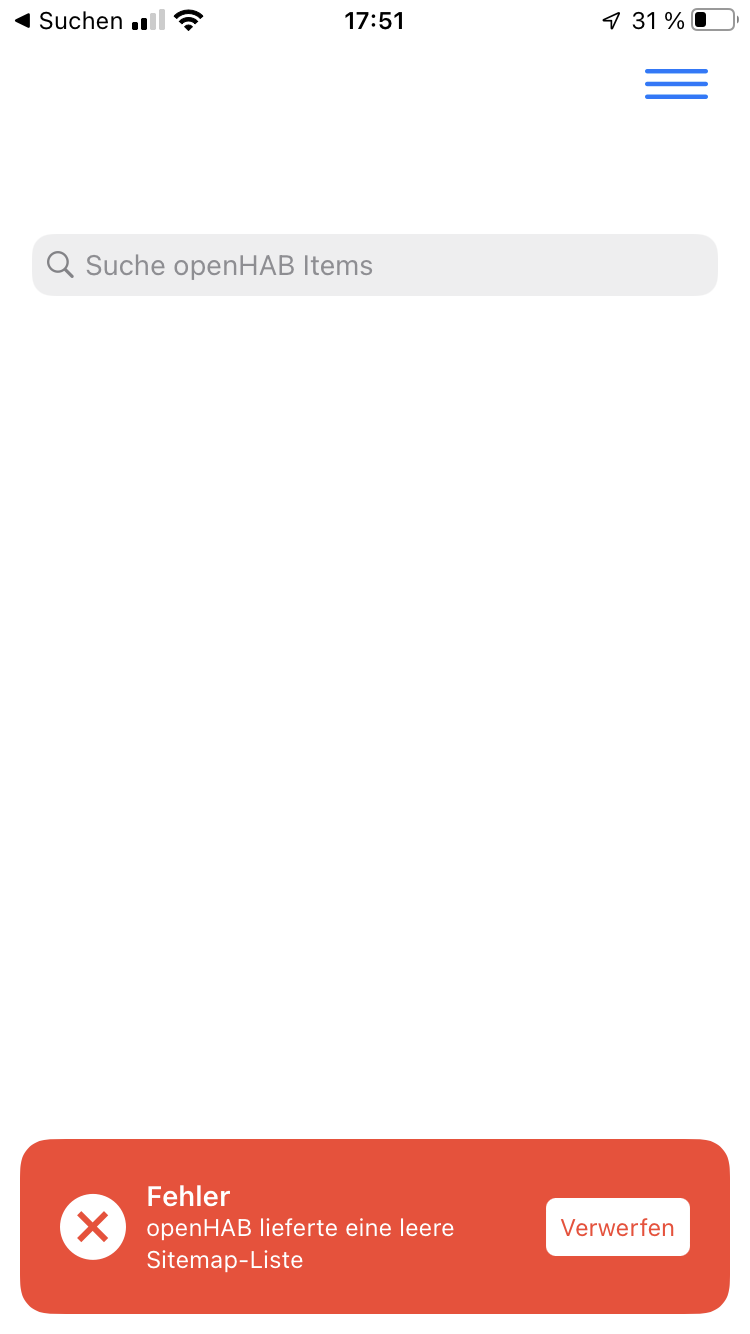

Updated yesterday to V2.4.39 on Ios 14.8.1. Same issue, app returns error “Sitemaps list empty”. Openhab in Version 2.
Same issue here: iOS app is version V2.4.39.Since the update yestarday, I cannot connect to Openhab v2 with error message “Sitemaps list empty”.

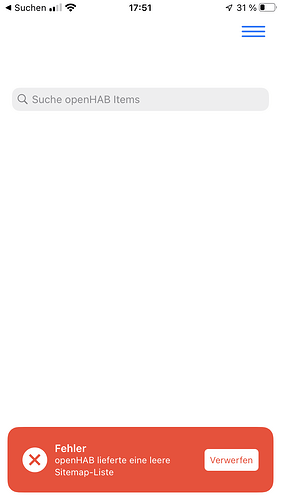

Same error here - update to the openhab app happens automatically - now all phones stay blank, no sitemaps are loaded and the red error ribbon shows in the bottom of the app.

My iphone has the last version from app store. 2.4.39 and shows the message - Openhab returned empty sitemap list -

Same issue on all of my ios devices with latest openhab app client. „OpenHab liefert eine leere Sitemap-Liste“. Does anyone found a solution so far ?

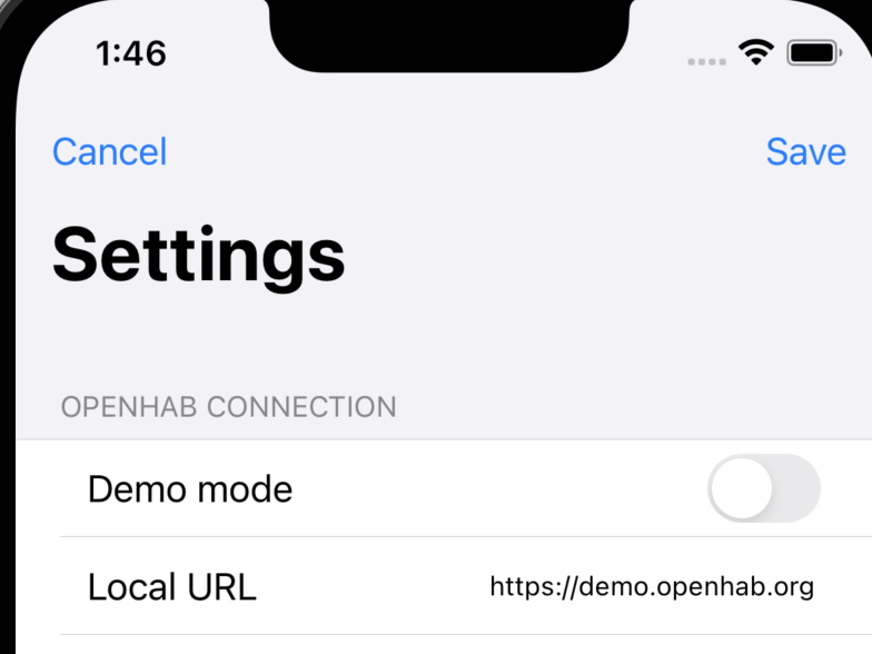

I just checked latest develop (assuming that was used to build latest available TF version 2.4.39) with https://demo.openhab.org/ (since I don’t use BasicUI anymore myself)
and seems to render perfectly fine
So if you are using BasicUI’s sitemaps (accessible via http://<youropenhab>/basicui/app) you should not get the empty sitemaps error.
But if you are using the OH3 Main UI (accessible via http://<youropenhab>) then please note the latest TF build does not contain support for it (anymore), more info avail in PR and will most probably get available again in a new TF build …
EDIT: tried with OH 3.2 and OH 2.5.12 and both seem to render sitemaps just fine … sounds like an OH 2.4 issue since all reports are for that version …
