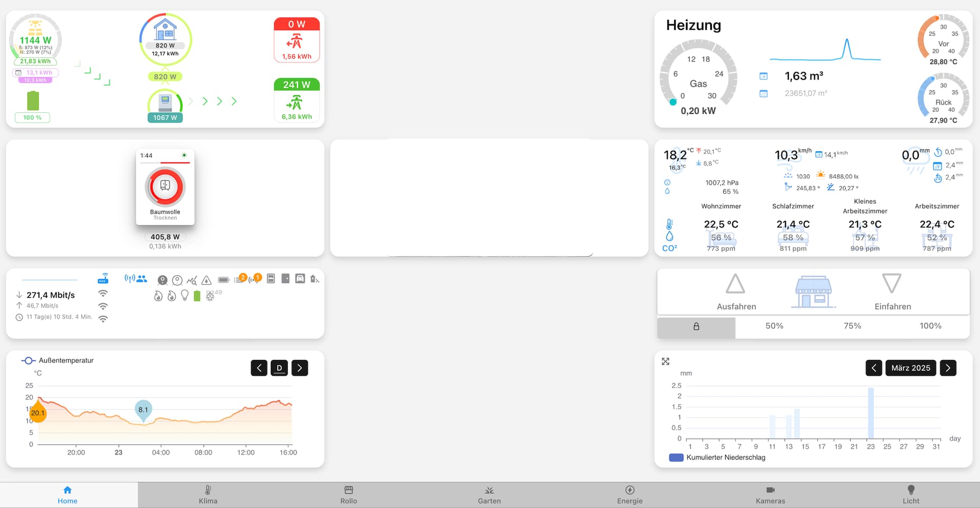

I have several own developed widgets with gauge and charts using persistent data.
In addition one widget is using repeaters to indicate issues with network sensors, battery state, etc.
Loading the page is very fast. Also changing the different pages with the tabs (Home, Klima, Rollo, etc.) is instantly updating the content.
However, when I want to open the settings menu to open the Things, Items or Model page it takes several seconds to get the “Settings page” displayed.
I removed some widgets for testing and this improve loading the settings page.
I’m just wondering why loading the Main page with all the widget is very fast. But it takes very long to unload the page???
