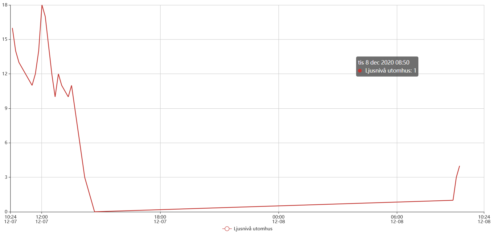

I noticed some small problems in the graphs in OH3, thought I could bring them up here.
Pasting an image of my lightsensor for the last 24 hours:
(Yes, it’s really depressingly dark up in Scandinavia currently)
Questions:
  1. The last readings always seem to be missing from the graph. When taking this image I had got at least four additional readings (I double checked the persistence database). Why don’t I see them in the graph?
  2. It was completely dark here from yesterday 14:40 till today 08:50 (Between those points in time nothing was saved in the database since the level didn’t change). Looking at the graph though you get the feeling that during those points the light level is slowly rising during the night, which kinda gives the wrong impression. Is this anything that could be done anything about? Or is it a question about me needing to persist values not only when changing but also periodically?

That’s why it is drawn like this. There was nothing in the database for the night and I assume that the first data saved in the morning was not 0, but some slightly bigger value (maybe around 1,5-2 if I can see that correctly on the graph). So the visualizer drawn a straight line between the last point in the night and the first point in the morning. That’s why it is not completely flat.
