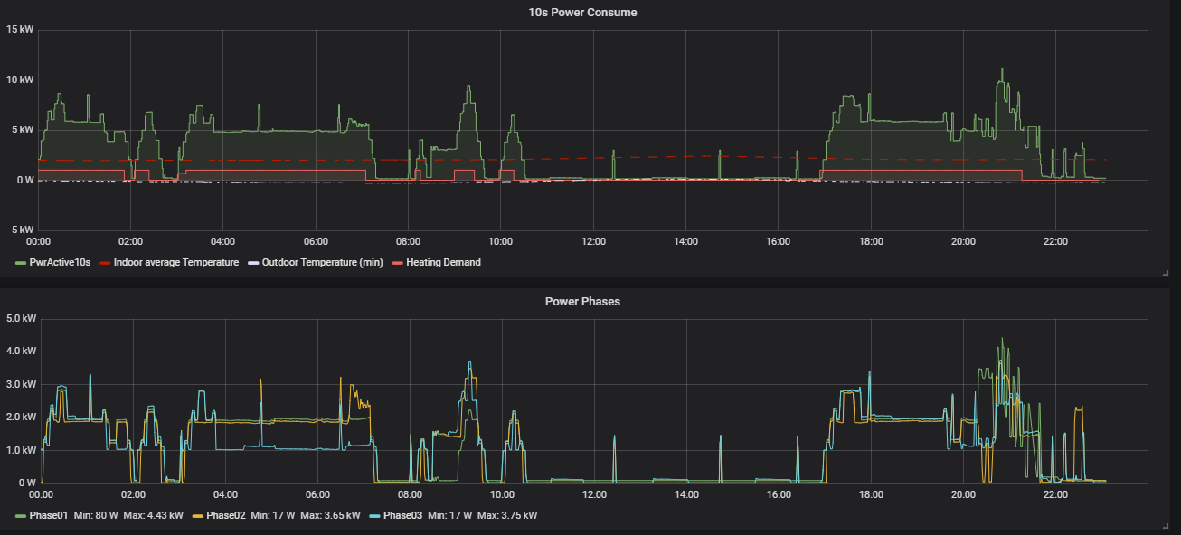

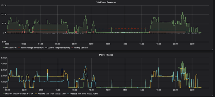

In my system I use the scripts below in order to fetch the consumption on all 3 electric phases every 10sec. This is good enough for me to calculate the overall consumption, consumed energy per phase and finally monitor the impact of different consumers in my home via Grafana.
I use the data from the local smappee as well to calculate a graph with 5min power consumption, as this is the interval, which the Smappee webservice displays. This graph comes handy in order to find out, how well the local Smappee inquiry works. The data from local Smappee and webbased Smappee API fit actually quite well. However, these values drift over time. Therefor I fetch the hourly, daily and monthly values via the smappee API. These values proved to be closer to the monthly bill of consumption from my electricity provider.
