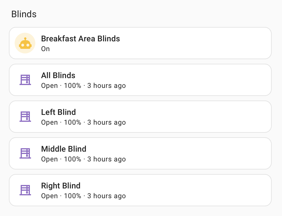

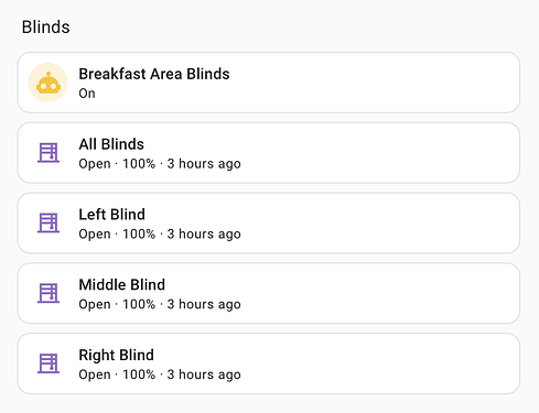

The only other complaint is that they don’t respond as a group, intermittently. If I send a command to the group of three it is hit and miss which will respond. I decided it was a Z-Wave thing. To get around it I have a script that takes the intent (all 100% open as an example) and staggers the Z-Wave commands by a small time period. That made them rock solid.

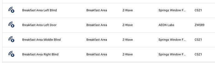

(that’s my Home Assistant)

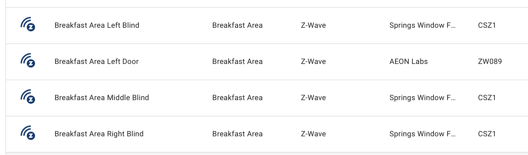

Mine show as Mfg Springs Window Fashions CSZ1 in Z-Wave

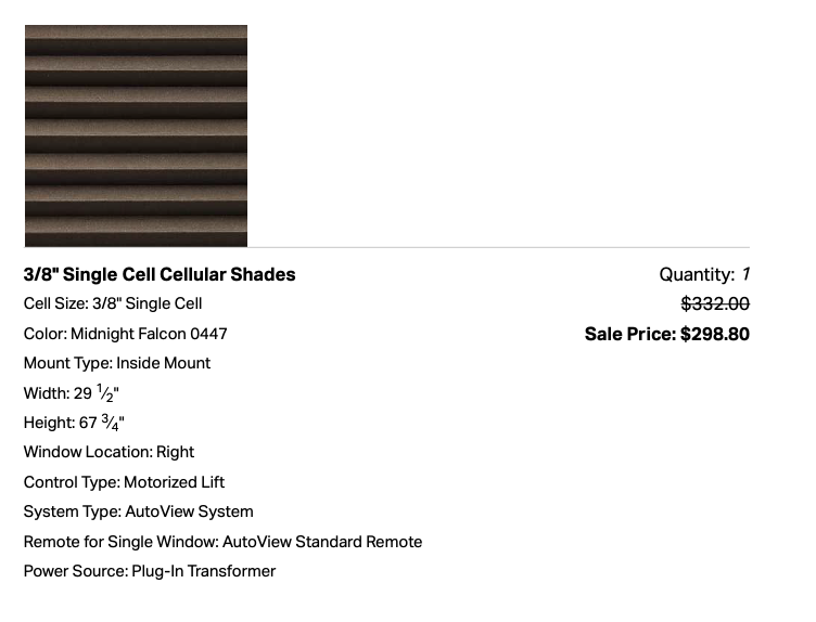

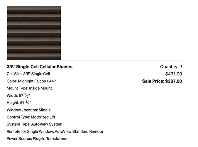

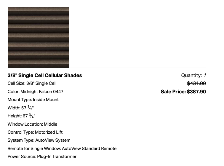

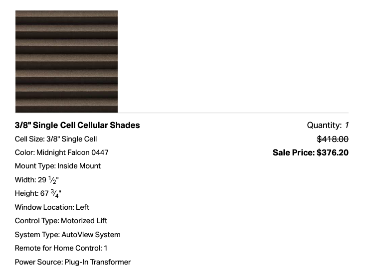

Pricing… through costco (dot) com for Bali blinds here is what I paid…
One of the two smaller ones is a higher price as it includes the more fancy remote control that is able to control all three at once. I don’t ever use that remote as the blinds are automated to my every whim.
