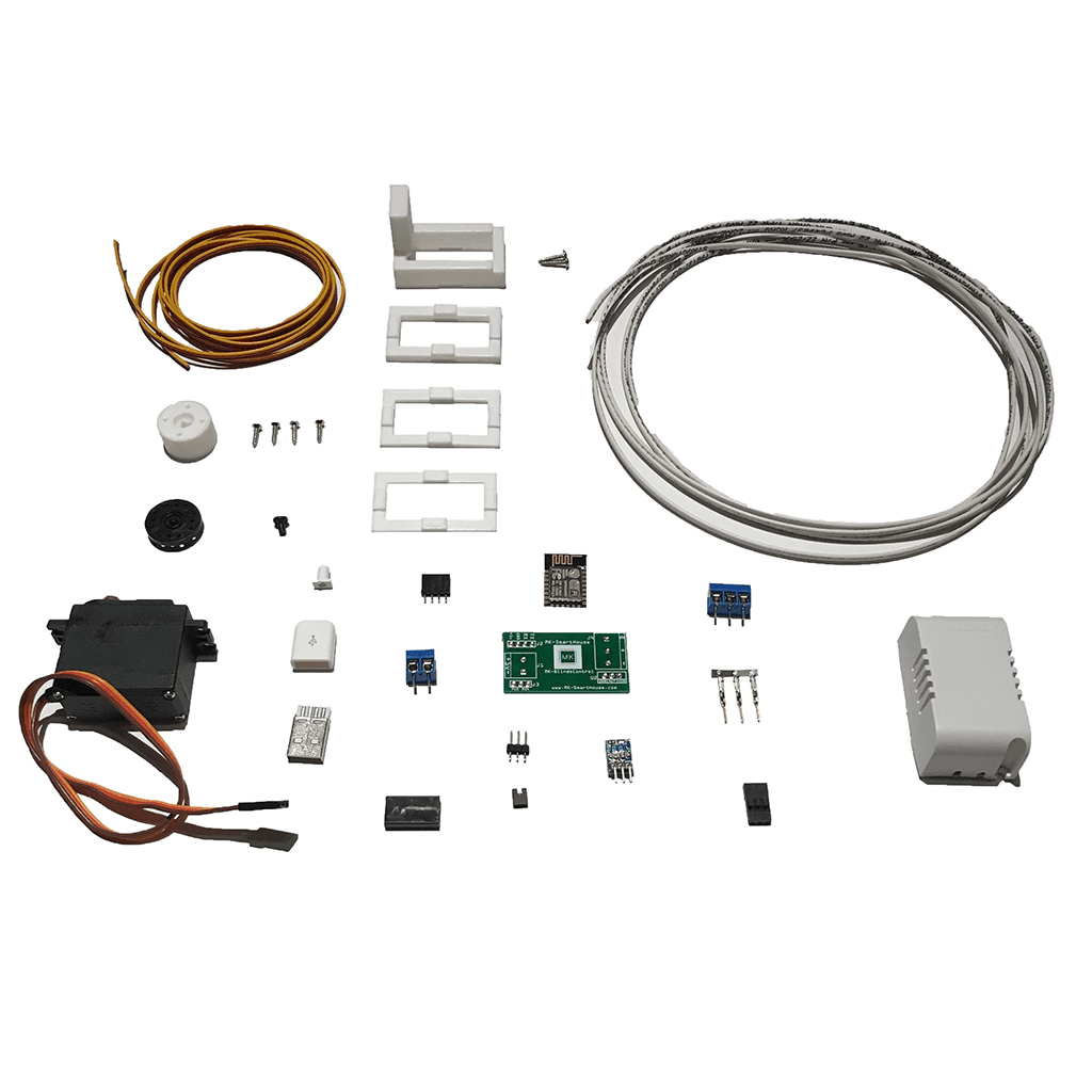

One more: An Add-On kit from MKSmartHouse. Very ‘affordable’, and worth a try. One can buy the parts and assemble them, and that is how they keep the cost down.
