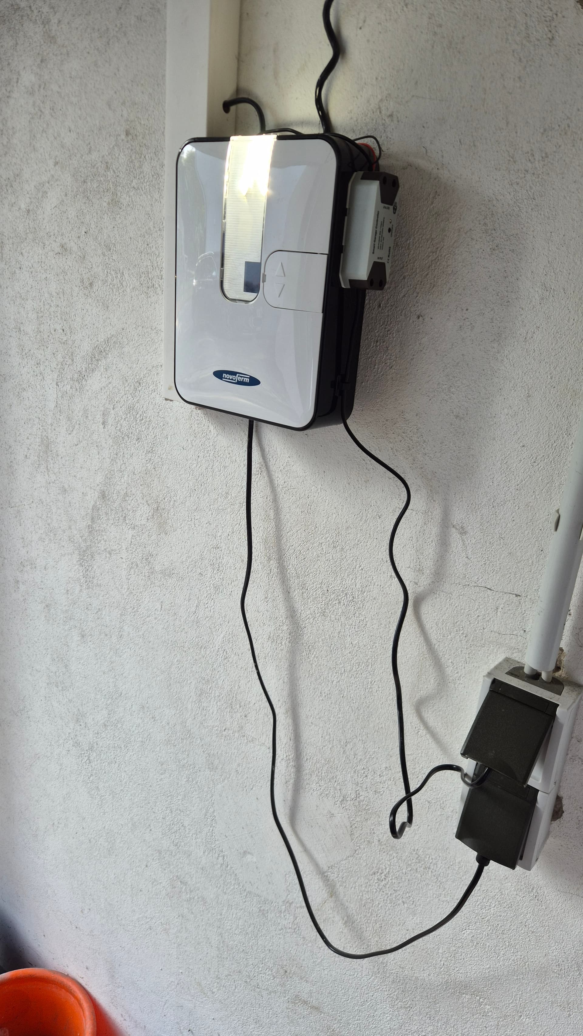

Installation was simple: just connect the two switch wires to the proper sockets of my Novoferm/Novoport unit. Then glue the SH128-W to the unit using the provided glue strip. Plug the SH128-W into the power socket and use the builtin button to try it out. Worked at first attempt.

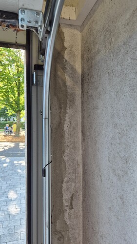

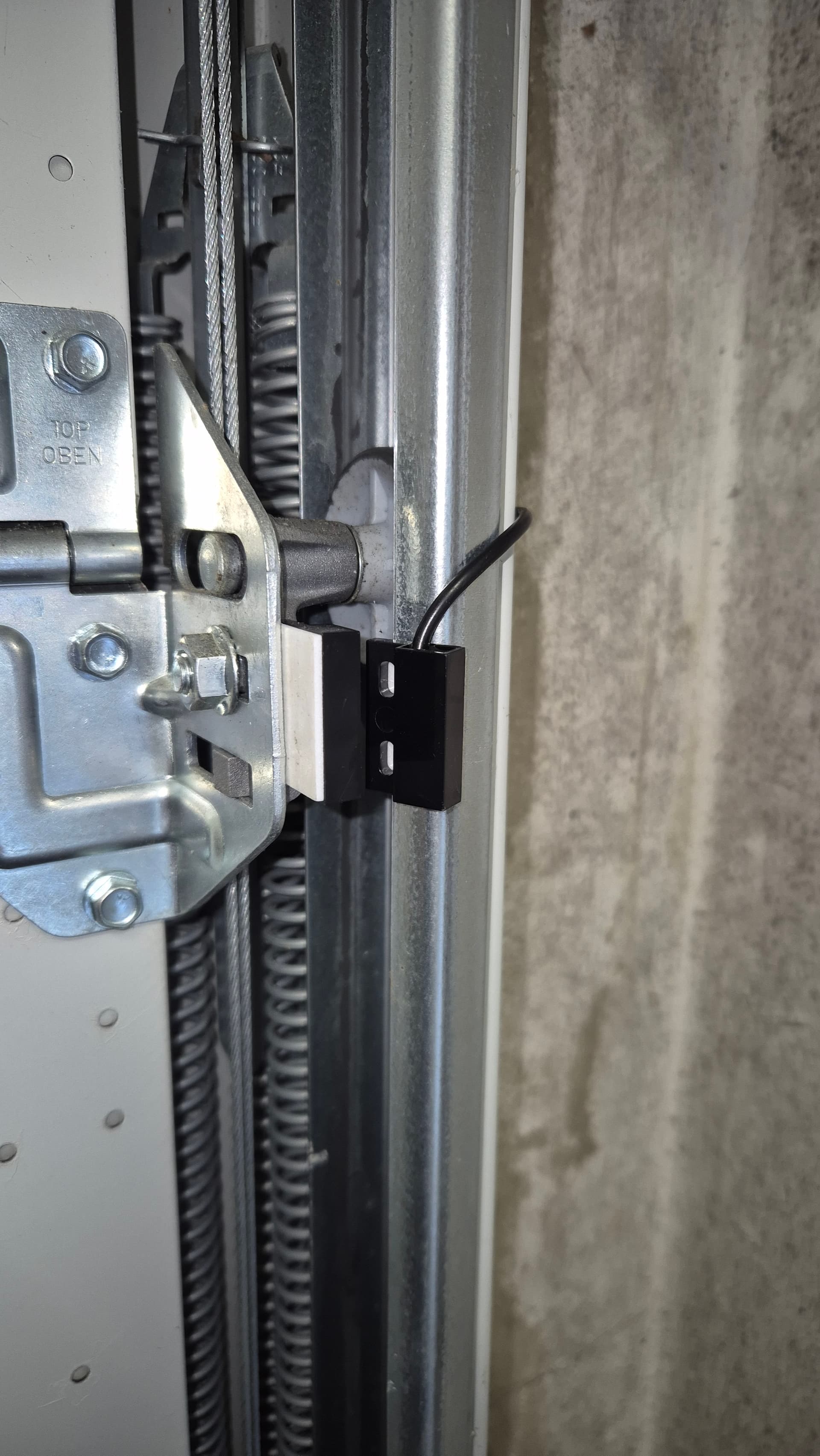

Next I just still fixed the reed contact to the door. I could instantly see the status changing in the Tuya App.

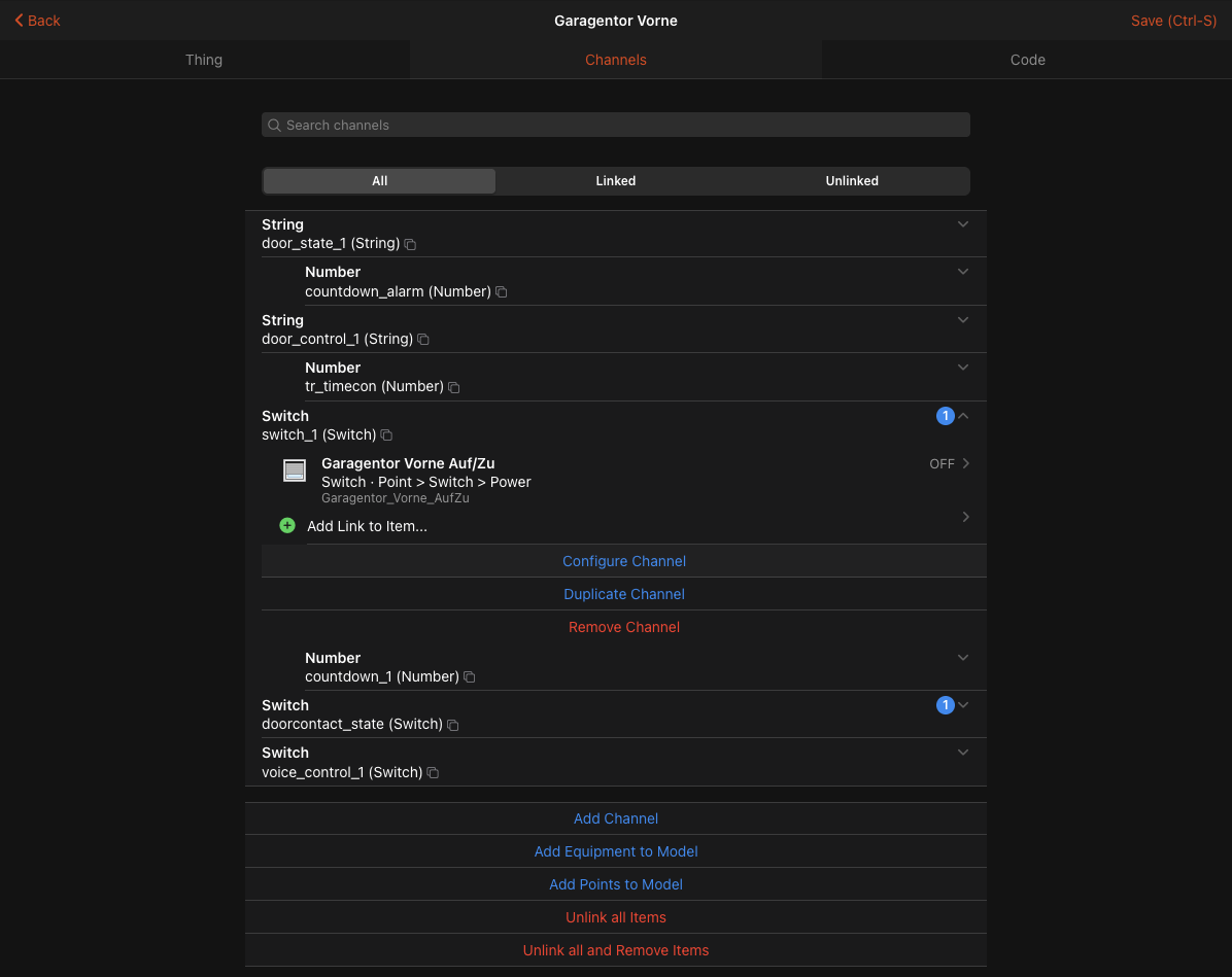

So far so good, if it was not for Openhab I would be done now. The Tuya binding works only with OH5, so I first upgraded to the version, then installed the binding. To set the binding up, you need to follow the binding’s manual meticulously - it took a few minutes but it worked for me. Then next, I created an appropriate Tuya Cloud Project “Thing” in OH, using the UI. That immediately went online. The binding supports discovery, so now it was easy to add a Thing for my garage door to OH as well. Next, I created and connected two Switch items, one for status and one for opening/closing:
And that’s it! Just configured things the way I wanted in the MainUI and now I am able to see the door status and also open/close at my convenience. Next I still plan to set up a rule that notifies me if the door remains open at evening.
